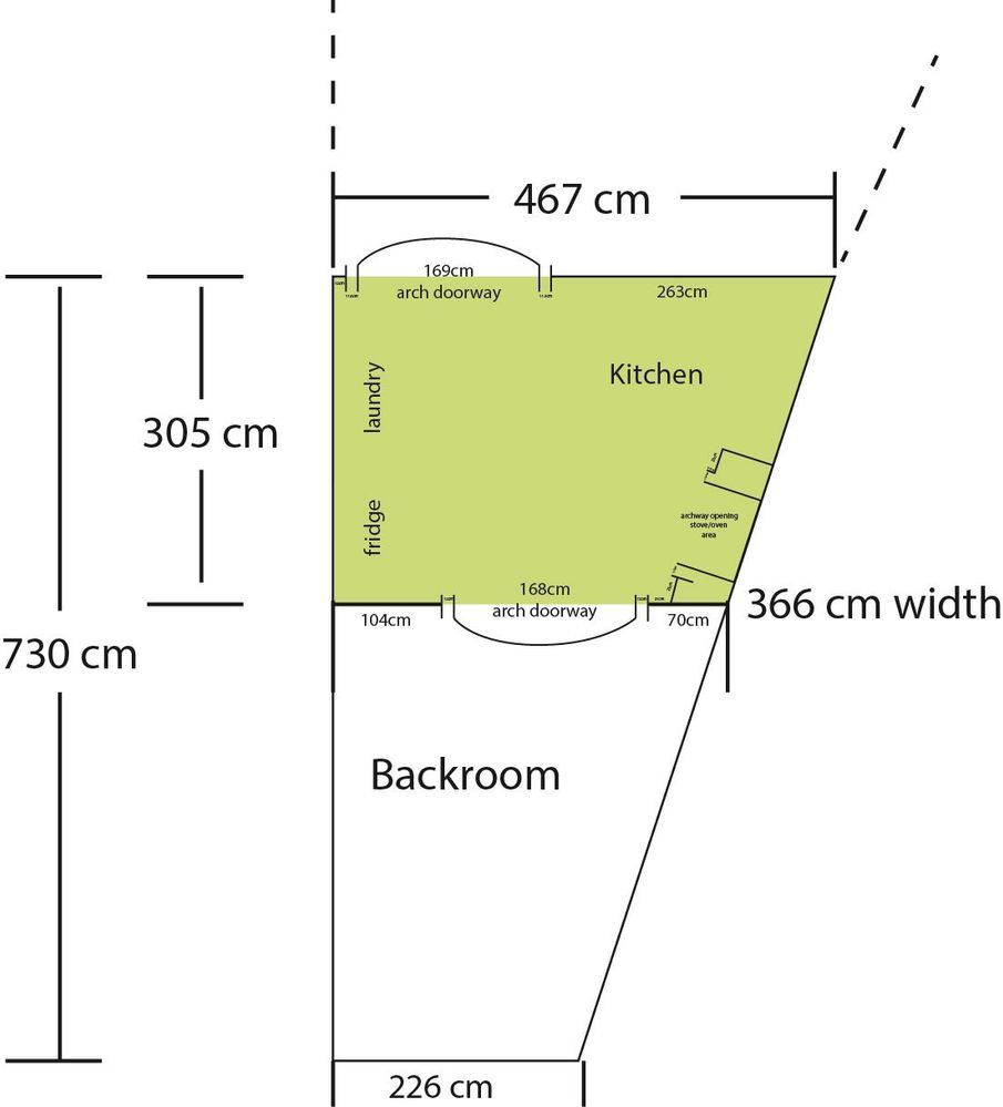

Hi @redracer01,
I've uploaded the kitchen layout and measurements. Sorry it took a while to measure. We've got boxes all over the place now and hard to move about.
Thank you for your help!
Rosana
Great plan @Rosana, that makes things very easy to visualise and I'm sure will help @redracer01 a great deal.

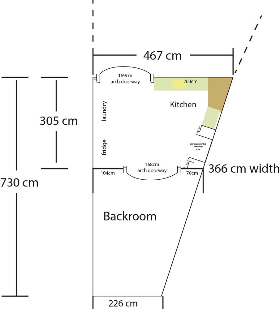

Hi @Jason
This image to show where the sink and cabinets are. We're going to lose the ugly table bench thingy in the middle. Tried using the Kaboodle software, but it couldn't register for some reason, I think it is because it is a weird shape. Trying to find other softwares at the moment.

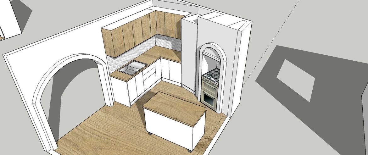

Hello @Rosana
Here is a sneak peak. I will post the rest soon.

Hi redracer01
That is fantastic! It was exactly what I was thinking too! Including the island! Was thinking the same. Thank you so much for this redracer01! You did a marvellous job of putting the arched doorway and arched oven area. Thank you again.
