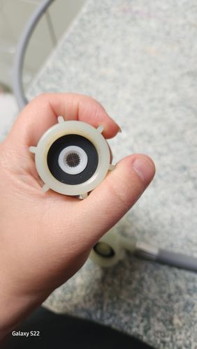

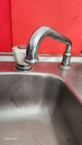

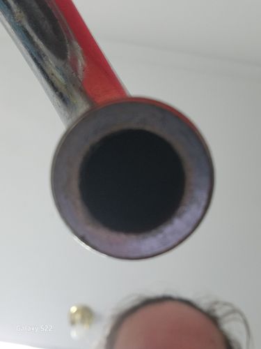

Hi im wondering what attachments i need in order to install my benchtop dishwasher.
I will attach a few photos to show what i am working with.

There's a variety of discussions on the community about connecting benchtop dishwashers. Due to the variety of different thread types on taps, you'll need to use an adaptor to suit your tap. The hose has a 3/4 inch coarse thread adaptor, and your tap has a fine thread. Products like this Kinetic Adaptor Aerator Kit can help you adapt from a fine thread to a coarse thread. However, this would provide a semi-permanent connection and would be difficult to take on and off if you still intended to use the tap. If you check out this discussion on Benchtop dishwasher tap connections you'll see some methods our members have used to create a quick connect setup.
