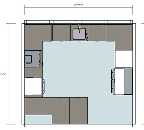

Re: New Small Kitchen Layout Ideas
@redracer01 awesome layout!
Wow @redracer01 that is very nice. I really think we have it right there.
Marg' thinks the microwave might be better over the oven but that is minor.
Thanks very much for your valuable assistance.

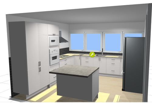

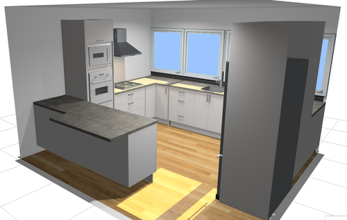

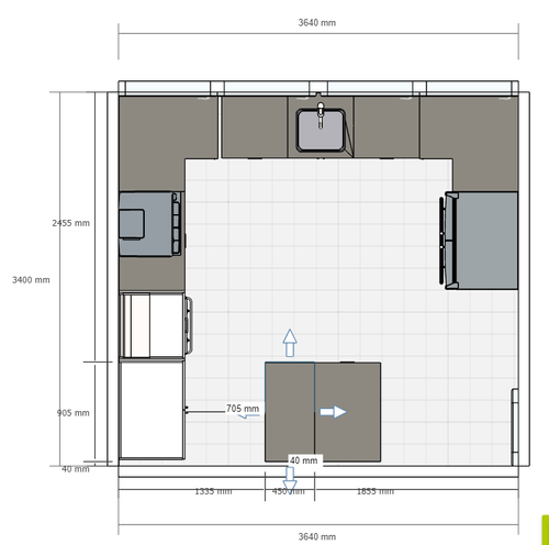

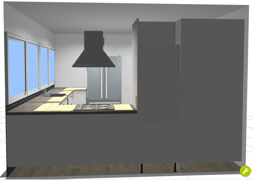

Hi @Footsore
Recently saw your post. I knocked up an alternative layout using the Kaboodle planner--I fudged the longer wall to 3400 just to fit the items bcos of Kaboodle's unit sizes. It includes an island based on cabinets for more storgae. You might need to get a "cut to measure" cabinet (e.g. pantry or cooktop) to fit the actual dimensions. I've included some snapshots below. Cheers, Peter
Or soomething like this:
@pete_brig,
What a great design you've put together there, I trust @Footsore will appreciate the alternative layout.
How are you finding the new Kaboodle planner, I was pleasantly surprised by the functionality?
Many thanks for sharing.
