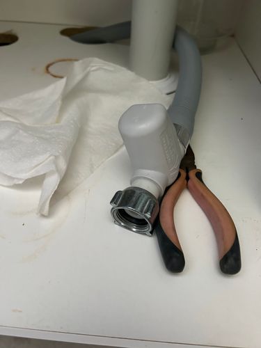

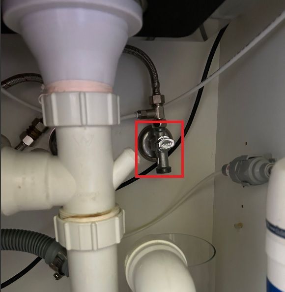

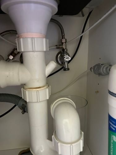

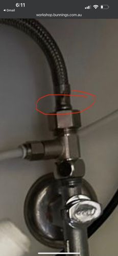

My kitchen 3 way mixer tap (Aquaport WELS 4 Star 7L/min Chrome Curved 3 Way Filtered Water Mixer) was working fine until I tried to install a replacement dishwasher.
Now, there is no water flowing from the tap when turned to cold, and no water flowing from the tap when turned to filter. The under sink shut off valve is set to open.
Water is not getting into the dishwasher - IE error message (water input). There is no kink in the hose etc. The water supply hose does have an anti-flood device.
Even after disconnecting the dishwasher water supply hose, and confirming shut off valve is set to open, the tap is still not running any cold water at all nor any filtered water.
Cold water runs from other taps in the house.
Any ideas?
Note - In the photo the shut off valve is set to closed.
