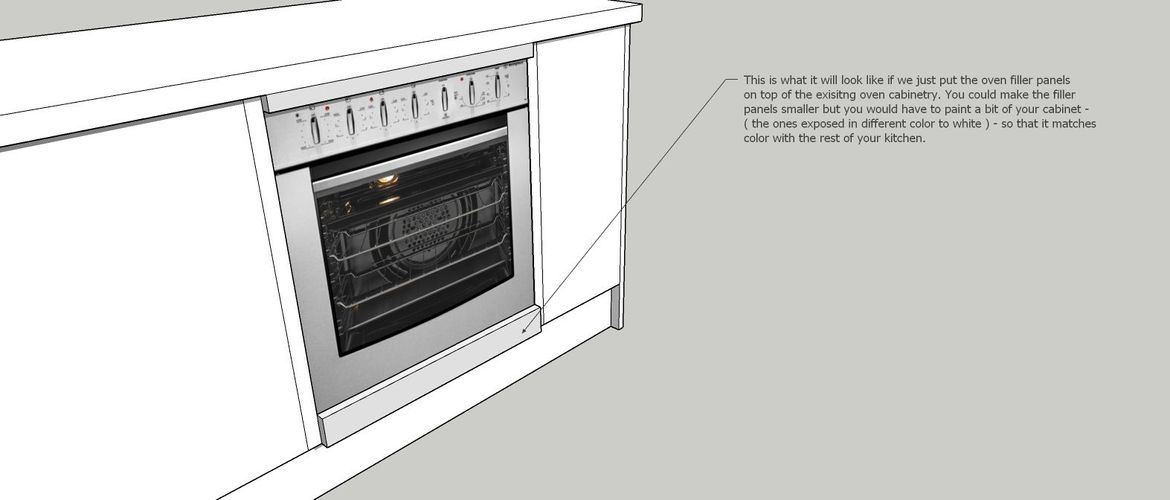

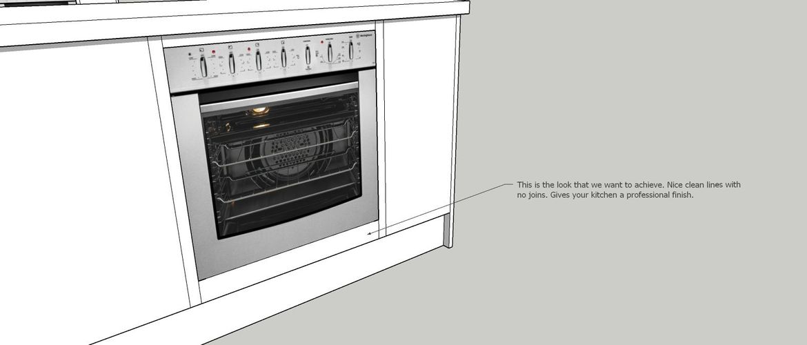

Sound advice from @MitchellMc should you wish to cover the oven gaps using melamine panels cut to size, it should make quick work of covering the gaps. If you wish to take the extra step, you can use MDF or dressed pine and prime and paint to the exact same color as your current kitchen. I noticed that your oven front is bigger than the allowed space in your oven cabinet. In an ideal situation if time permitted the oven front would have been measured and the space adjusted. Since this is our current situation my suggestion will only apply to what you currently have. Below are a some images that present several situations you may find yourself in while attempting to cover the gap with oven filler panels. Should you have any questions please don't hesitate to post here at workshop, remember your trying to gather information there are no silly or funny questions. Please keep us updated and possibly a post on the final solution you have arrived at.
