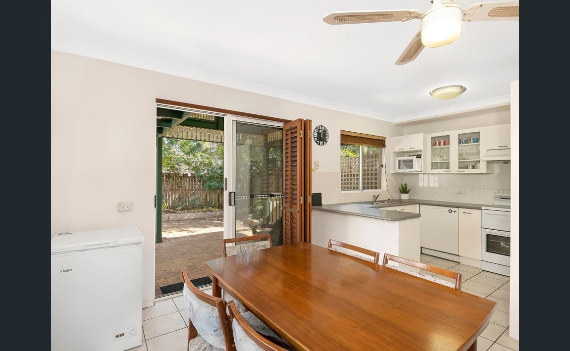

Just thought I'd share before and after photos of my original 1995 kitchen after painting.
I painted the cupboard doors and panels with White Knight Tile and Laminate Paint, using a small roller generally and a paint brush for corners, and after cleaning with White Knight cleaner. After doing a 'trial and learn' on the inside of one cupboard door, painting was easy.
I removed all the doors and hardware and painted the visible panels in situ, and did two coats. It took 4 x half days altogether. An easy and cheap job which I would recommend to anyone capable of removing/replacing hinges and door handles.
AFTER
BEFORE
