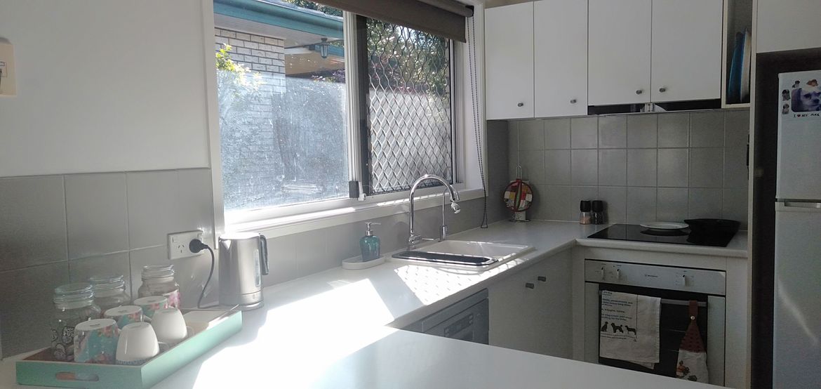

Painted splashbackPainted splashbackBeforeBefore

@MitchellMc just wanted to say thank you! Finally remembered to post a photo, I finished some time ago (Thanks covid!). Now on to next project upcycling pine chest of drawers!

Hi @Trish2,
That looks fantastic! You should be immensely proud of the work you have put in as it has really paid off. I'm so glad this worked out for you and I appreciate you following up with some pictures so we can all see the finished project.
We look forward to following along with your pine chest of drawers upcycling project and would encourage you to share it with the community as well.
Many thanks for sharing your results.
