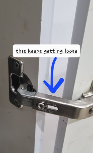

My problem is the hinge on the corner cabinets gets loose so I gonna tighten it a few times a day I'm over it

My problem is the hinge that holds the corner door I gonna keep tighting it or the door just flops

Great photo it really shows your point well.
I am thinking if it was my hinge you might need a replacment hinge might be the strongest repair as you have had to try uber tighten that screw over time. Some times you get hardware that is not too specifications and that screw mount might be worn over size now too.
Loctite like @MitchellMc is also good to start with but for the price of a new hinge. Your sanity is worth saving .
I would use both a new hinge and loctite.
@Lindilou Says they on there 4th set of hinges. Maybe change brands I would almost want to add a one or 2 extra hinges but that requires so accurate machining.
Just to add to the suggestions made, I recommend having a look at the Hafele Salice 70° Bifold Corner Hinge Clip On - 1 Pair. Please note that both hinges must be replaced when upgrading them to the new set. The Hafele set is much more robust as the adjustment is located in the main body of the hinge.
