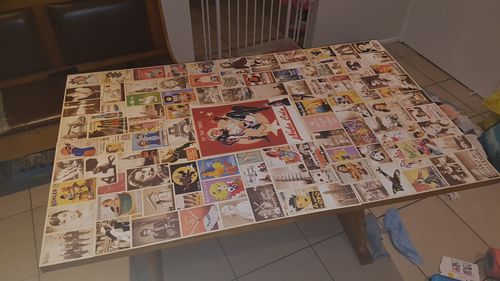

I'm revamping my dining table and I'm going to be covering it with pictures (vintage postcards).  So hubby and I have decided a clear epoxy finish is probably best but neither of us has used epoxy before.  So What I'm wondering is which product would be recommended for this kind of project? Also it's a 6 seater table - any ballpark guesses as to how much I'd need?
I have a small coffee table I'm going to practice on first, I'm not just jumping into the main event :smile:
Thanks!

I'd recommend you use something similar to Feast Watson 1m² Glass Finish. The only other two-part resin options are Protite 250g Fibreglass Resin which is not suitable, and Protite 500g Clear Casting Embedding Fibreglass Resin. I've used the casting resin a few times before, and I would be hesitant to recommend it for your project. It's generally used to cast small objects in, and I believe that being a polyester resin can have issues going hard when exposed to oxygen. As you can imagine, it is fairly hard not to have it in contact with oxygen in your usage.
The Feast Watson Glass Coat is also available in a 0.5m² quantity. You should see some stunning results using it.
