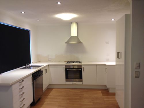

Hi I would like to remove my scratched stainless steel splashback however I am unsure how to go about it without removing the plasterboard behind any suggestions would be greatly appreciated.
 this is before the splashback was installed.

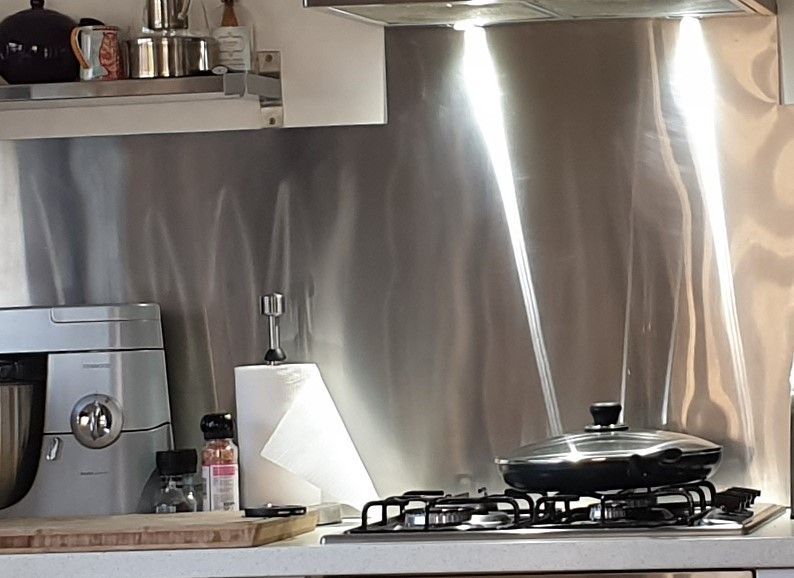

I would prefer tiles. The tenants cleaned it with a cloth that has scratched it to the point they can not be buffed out! The real estate just thought that is how it was cleaned. I was devastated, due to the clause in the lease with specific care instructions!3 metres of stainless steel. I would like tiles instead.3 metres of stainless steel. I would like tiles instead.

It might just be an artifact of the image but there seem to be ripples and distortion in the stainless sheeting. If there are this might indicate that it is not actually adhered all that well to the wall.
