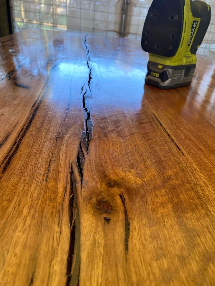

I repaired our 6-seater Marri wood dining table over the past couple of weeks, it was cracked through the entire table as well as some putty had started lifting. This table cost us $1500 brand new and cracked within 12 months, the Gum Vein structure is a feature with Marri wood and this can happen, I have seen this happen to many tables. Some people on FB have even turned repairing Marri wood tables into a side hustle.

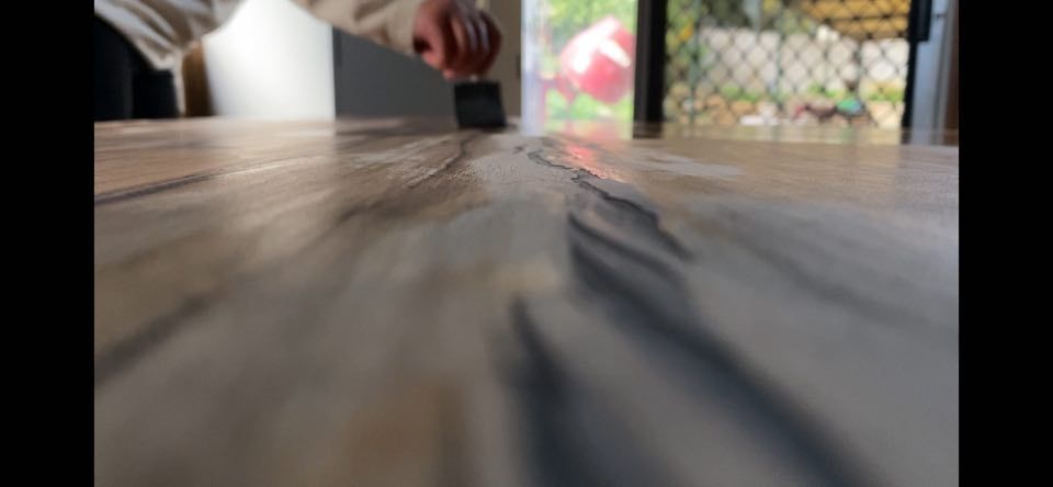

I used the Bosch heat gun and scraper to take off the previous layer of varnish/top coat.
You will need to move quickly with the gun otherwise you can start to burn the table.
Move the gun along while you scrape. This heats up the varnish and makes it easier to remove.

1st I used my Ryobi cordless sander and continued to remove what was left of the varnish. I had a pack of a mixed range of sandpaper so I had this opportunity to try each different grits of paper.
I also switched over to my husband's Ozito cord sander that's in the cover image and used up some old sandpaper (Yellow role).
Step 3
I used a small scraping tool to scoop out the putty and fill the gap, I left this overnight to dry before sanding, I then used a lower grit sandpaper 80-grit to sand the putty area.

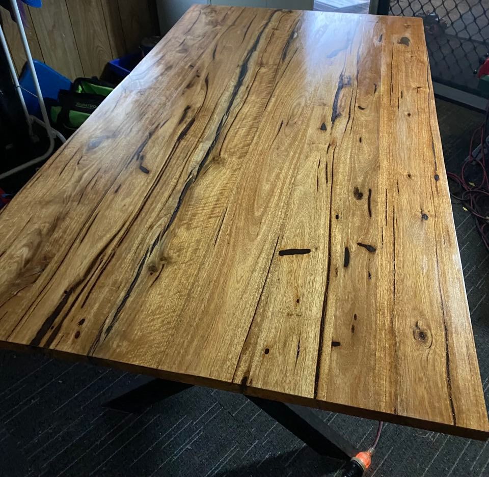

The Varnish - using the foam brush I gave this a number of coats, the heat gun again helped to dry faster, I managed to get 2 coats done within 30 min, I let the table sit, the next day I gave it another 2 coats and let it naturally dry, this varnish dried surprising quick considering we're in the colder months.
Step 7
And then... we moved the table back inside ready for dinner time.
It was so much easier then I thought it would to repair, I can't believe we lived with that crack in the table for 4 years!
