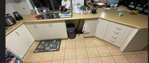

We are wanting to do some work on our kitchen. Following are the things we would like to do. This is going to be one at a time.
A. Changing the Rangehood to this: https://www.bunnings.com.au/bellini-90cm-stainless-steel-canopy-rangehood_p0186539
my existing one is:
B. Changing the Cooktop to induction or ceramic cooktop, like this: https://www.bunnings.com.au/bellini-60cm-induction-cooktop_p5103044
my existing one:

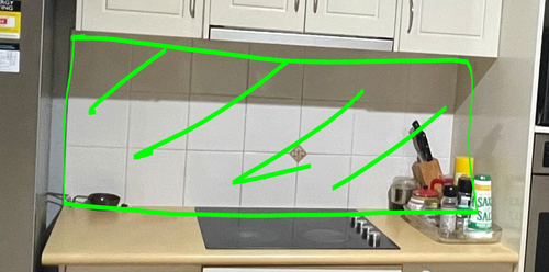

C. Change splashback to this: https://www.bunnings.com.au/vistelle-700-x-745-x-6mm-mist-glass-splashback_p2669127?gclid=CjwKCAiAsaOBBhA4EiwAo0_AnEVwjCqldXC314eDagMnlC9fNwr7BqUjAgAxkbJzNtjdM3wbZvV9IRoCaOsQAvD_BwE&gclsrc=aw.ds
The current one is :
😧 install new Dishwasher:
The current one is:
E: install new oven:
F: Changing the Benchtop:
Current one:
We would like to know what is the best sequence to follow to achieve what we would like to do.
At the moment, the main priority is B, but still, we can follow the right logical order.
Any suggestion is highly appreciated.
The main reason is, we don't want to undo (affect) the job which has already been done
Sorry, I forgot to add another item,

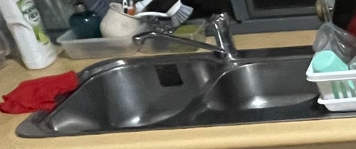

G: Kitchen Sink
Hi @Sugar,
It sounds like you have some fantastic plans in the works and I can't wait to follow along.
The sink and cooktop will need to be installed into the new benchtop. You wouldn't want to damage that new benchtop by removing tiles above it, so I'd suggest that the tiles' removal needs to be done before the bench installation.

Hi @Sugar , these are great plans and informative pictures.
Having recently had a kitchen makeover myself, the order in which mine was conducted was as follows:
1. Upper cabinets and new range hood installed (as they lean on the bench tops to hoist up the upper cabinetry.)
2. Removal of cooktops & sink, then bench tops and backsplash.
My oven was an under bench oven. If yours is the same, then the oven and dishwasher can happen later. If you’re (re)considering a freestanding oven with stove, then the bench top will have to be cut to measure the size of the oven. Ideally, your range hood and stove top are the same size.
Enjoy your renovation. Look forward to seeing your new kitchen.

@EricL - "Tiling the splashback yourself is another job you can do yourself."
I believe we will be able to do this ourselves in following indicated areas.

For plumbing side - We will be having new sink and taps as well. We are working on type of taps we would like to use. Currently it is like this:
but we might be going with this once we have new sink

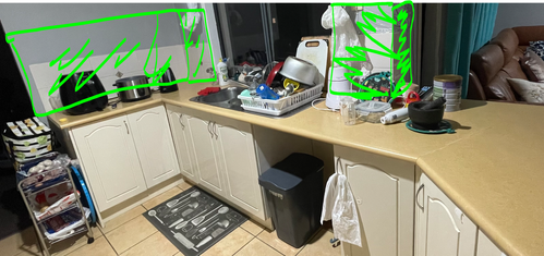

@EricL With some budgeting going towards laundry renovation, the kitchen renovation is going to be delayed (looks like it) for a while.
However, the Flooring still being priority, we are thinking if the flooring job can be continued to the kitchen and living room areas while doing in the Laundry area.
I am a little concern about the future once the flooring is done now in kitchen area based on the current design and purposed design (we want to go with this future). Following are the design again.
Current Design
Purposed Design
If you see current design, one end of the benchtop and the whole cabinet finish off on angle, whereas the purpose design has perfect L-shaped benchtop design.
Let's say we do the flooring now around the current design ( which has the angular finishing - indicated by Green markers), and later want to start Kitchen renovation, will we be able to do the adjustment of the Hybrid flooring around the Angular area ? Will we have flexibility of taking out the Hybrid panel and etc.
Apologies if I am not making sense here.
In overall what I want is with Purposed Desing, we might need to add, cut, take out, reinstall hybrid flooring to make the seamless flow around the Angular Areas, when they are turned in to L-Shaped, will I have any difficulty ?
And, will I have more moving opportunities/ flexibility if I go with Hybrid Flooring or proper tiling ?
I really appreciate your advice here.

How essential is that chopped off cupboard area? Would it be possible to shorten it without ripping the whole lot ot? That way you could work on your floor in preperation of the new kitchen benches?
The carcass should be able to be dismantled from each other (inside cabinet wuill have screws between each shell) and the bench can be cut through using a circular saw and handsaw.
Thank you for letting me know that your kitchen revamp will be delayed. I strongly recommend not doing your flooring in the kitchen until your new kitchen is installed. It is very difficult to rearrange the hybrid flooring once it has been installed and there is the possibility that the panel lengths will be incorrect which means entire sections will need to be relayed and re-cut.
From an installation point of view, it would be better if the flooring was installed only once and that is when the new kitchen is put in.

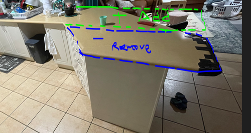

I might be misunderstanding here something.
Please have a look at a simple drawing I have drawing here.
Red dotted rectangle = The section that will be created when the benchtop will be changed to L-shaped, which will require already laid flooring to be removed to create space for cabinets.
Purple Traingle and Trapezoid = Sections that will be removed once changed to L-shaped, which will not have any flooring laid previously, and which will require to have new flooring done.
Are you saying it will be very hard to have consistence and seamless placement/ flow of the flooring on either sides of benchtop/cabinets that will constitute after adding or removing or whole or a part of the flooring, if I go ahead now and follow above concept ?
I always had an impression that hybrid flooring has flexibility of removing from certain part, adding panel as required and can be slided to adjust as per required. Thanks for explanation.

Good Morning @Sugar
Yes I am saying to remove that end of the bench to allow the seemless install of the flooring. Pretty much remove that bench back top the left hand side of the rectangle in the drawing you did.
Thats the eternal problem of fitting out a kitchen while still using the same. When I did my kitchen we gradually shifted around the room until the flooring was done eventually ending up in the laundry even 🙂
Things you could do.
By a cheap table.
Build that new section you will install and then when you chop off the end of the current bench you could place it on that temporary to give the prep space you want.
Schedule the floor and removal of bench closer together time wise so less impact.
Trying to get an area level/looking that that is no join is a hard thing to do, everything from finding the floor isnt level, things in the way, discoloration between old and new as the old went down before the new. All add up to a more complicated job. I agree with @EricL its preferential to do in one go.
Unfortunately, that is not possible. You'll need to wait to have the flooring done. You can not simply add and fill in areas after the flooring has been installed. Hybrid flooring has a clip-lock joining system, which starts at one wall and needs to be laid in a continuous motion across the entire floor in one go. If you were to lay it now, once you come to install the additional section, you'd need to pull all the boards up again, right across to the wall, if not the entire room.
