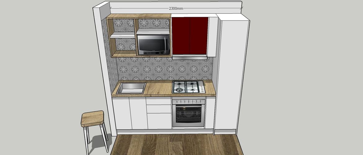

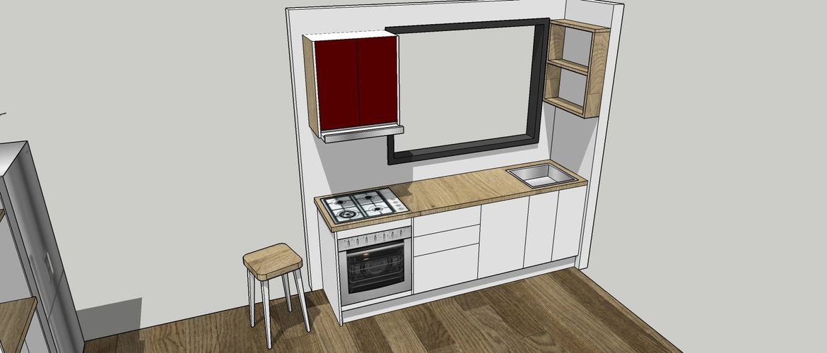

I have a very small kitchen to do in a shed, i only have 2.3m in length, only space for 1 long bench and would like to put sink and stove in if possible and as much storage kitchen stuff. Any suggestions would be appreciated.

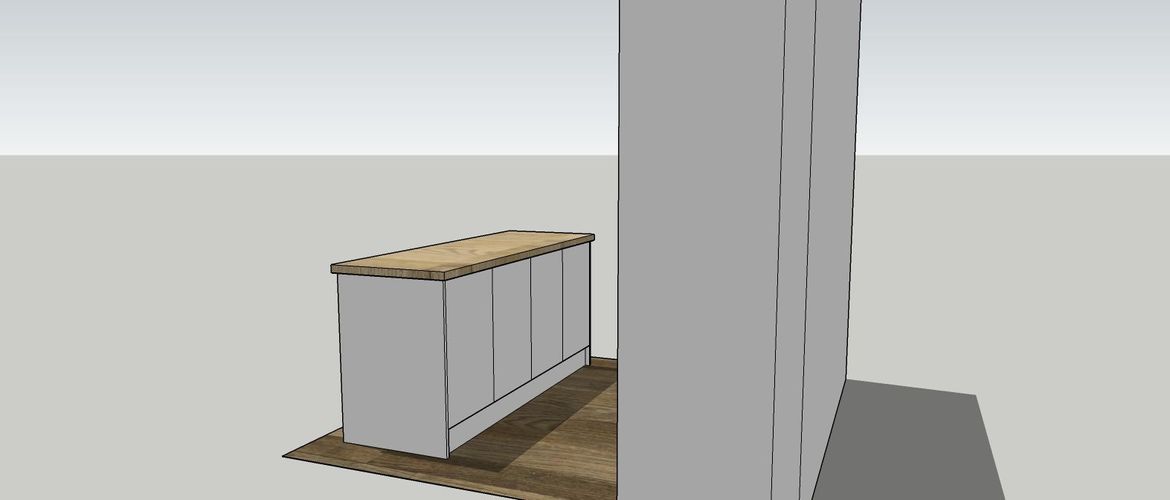

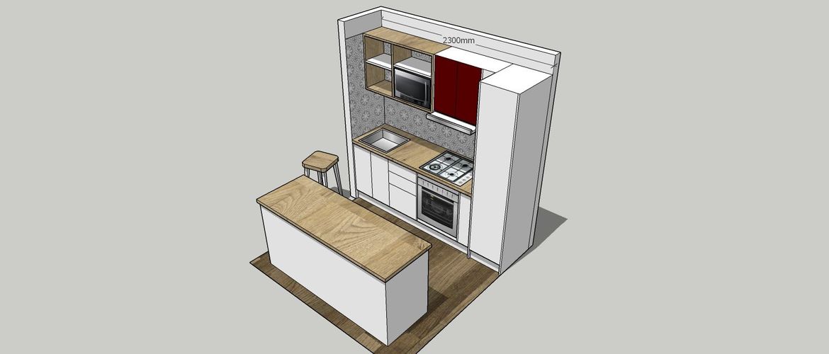

Hello @Stacey1
Here are some suggestions. If you have any room left maybe you can build the mobile island as well. Hope the drawings help.

I really like this and  have a window above the bench and only 600 of wall for cupboard or microwave on the left. The roof height is 5.5metres do we need to have a range hood? I also have a pantry under the staircase so i could have extra bench and draws in that space. Also the plumbing for the sink is on the right hand side.

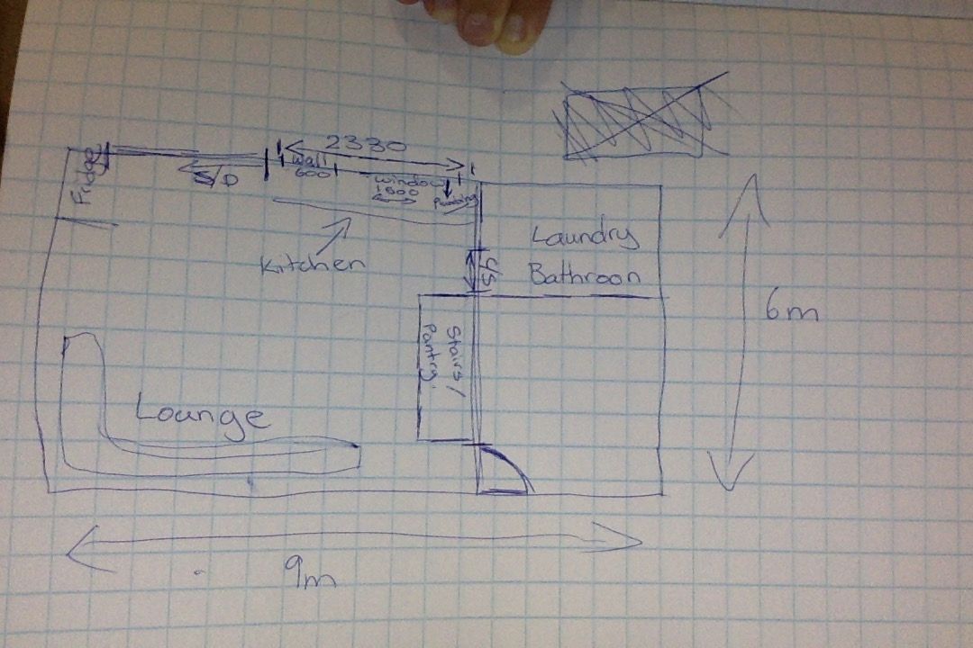

How big is the window? How far is the window from the left wall? You need a rangehood to catch grease and smoke from sticking in the kitchen. Maybe a picture of the area would help or perhaps a sketch, does not have to be pretty just accurate. 5.5 meters? Is it an old pre-war home? Take a picture of the staircase as well if you can and please post.

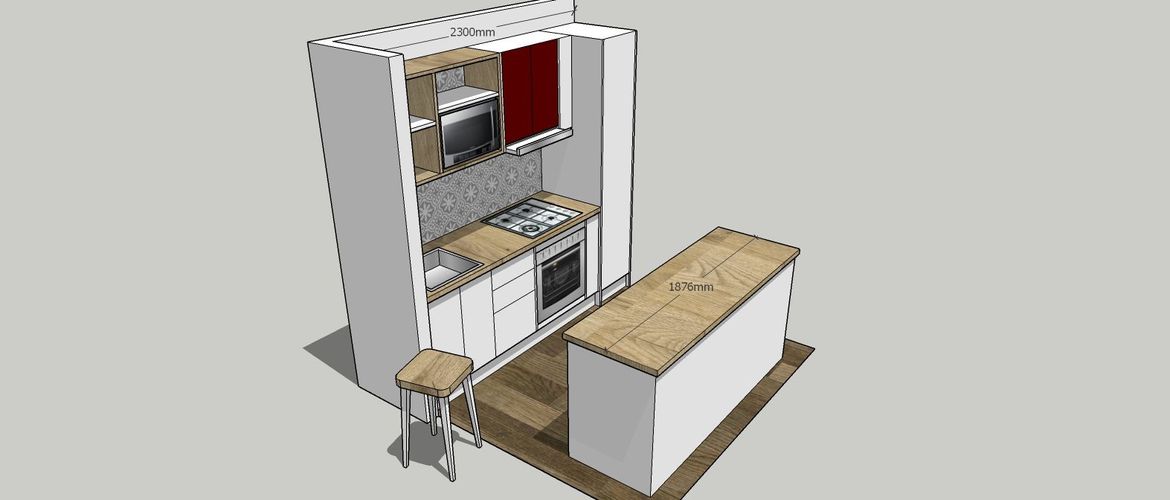

Hey
Window is 1500 long, i have 610 of wall space on left of window. This space is in a shed we have built not a house, just trying to work out a design to get most storage. thanksPhoto on 29-9-20 at 7.21 pm.jpg

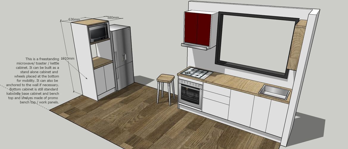

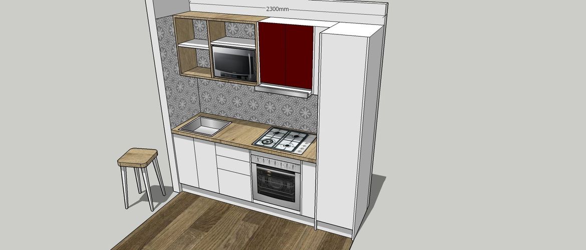

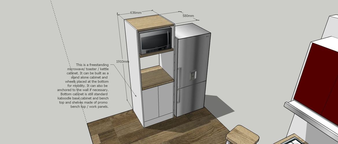

Hello @Stacey1
Here are the revised drawings and a suggestion for your microwave oven.
