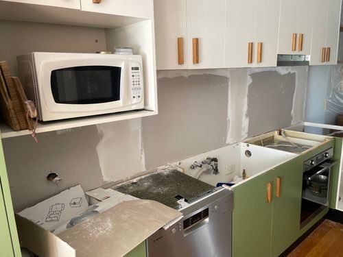

Hi, we are updating our kitchen and have just replastered the splashback. I had planned to put up aquacheck boards but miscommunication with contractor has left us with regular plasterboard.
It’s my understanding that waterproofing isn’t required for a splashback, but I would prefer to do it anyway to be safe. In chatting with the tiler he’s recommended priming the plasterboard then going over with waterproof membrane. Just hoping to get some advice on whether there’s any specific products I should use for those tasks.
thank you!

Hi @MitchellMc and @EricL, I have another question re this one. The plasterboard that was put up turned out to be very wonky, so I engaged another plasterer to rectify it using hard plaster (I believe he used the 45 cornice cement).
I have tiling booked for Saturday (7 days after plastering) and don’t think I’ll have time to do the full waterproofing. If I were to just prime the surface instead pre-tiling, would that be sufficient? And if so, what product would be suitable? Thank you!
