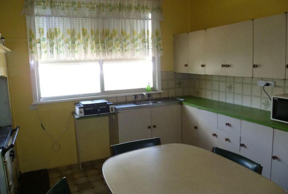

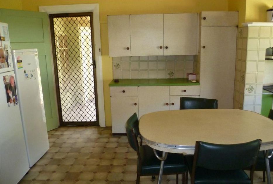

Hi there, I'm now thinking of my kitchen reno, having almost finished my tiny bathroom.  (Will post pics of the bathroom as soon as it is painted.)  Inspired by the makeover kitchen posted recently which now looks fabulous, btw, wondered if anybody could suggest a makeover for my old kitchen.  I am now on a very strict budget and so wanting to save as much money as possible but yet do the very best I can with it.  Here's a couple of pics of it.  The room is quite large.  I have an old wood stove in one corner and the picture of the kitchen sink and window just shows it on the left hand side.  I am wondering whether to have it removed and try and sell it and then take away the mantlepiece but that will cost money on its own!  Help!  Keeping it there means I lose valuable counter top space.  Any suggestions would be helpful, thank you.

Thanks to both of you! What I want is to get rid of those old cupboards and counter tops, firstly. The counter tops are far too narrow, the cupboards are not lined and the lower cupboard shelves are now not straight which means things tip over and you have to try and find a level bit to put anything on. So not keepable! I've had a look at Bunnings kitchens and although some of the cupboards seem quite budget-priced, when you drill down you realise that each cupboard has so many add-ons to the price, it works out that they are not cheap at all. I just want a clean serviceable cupboard. I will forsake all the trims due to my budget. I would love timber counter tops as in your suggested pics, but again can I afford it? My budget? I have about $12,000, not much more. I will make do with the stand up stove. It's not so bad. I have my fridge already. I would need a new sink and I was hoping for a large pantry-type cupboard in one corner of the kitchen, perhaps on the opposite side to the sink. So it's the cupboards and counter tops, really, that I need to replace. God only knows what the plumbing is like once you reveal it if the bathroom is anything to go by!!!!!!! I also wondered whether I will be better off keeping the cupboards in the same style, following the walls around the kitchen or could I be a little more daring and inch out into the centre of the room with some kind of cupboard? Does this make any sense to you at all?. Oh, I will be replacing the floor with vinyl and painting the ceiling and walls, of course, plus light fitting and all the trims.
Oh, re your question on how long I'm likely to stay there, I'm thinking two or three years, try and sell it and move to a larger town where there are more facilities, etc.  I'm in my 70's now but I bought this house as a project for myself as I wasn't ready to go into decline yet and I'm enjoying it in a nightmarish type of way but I just want to get it to an acceptable, functional level.  I'll let the next owner put the frills on it.

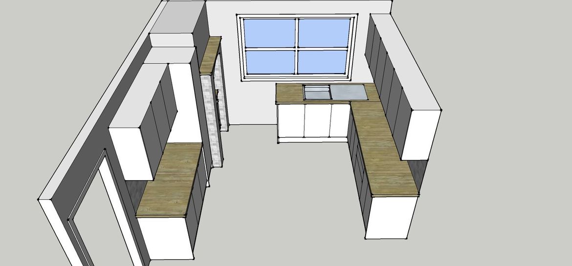

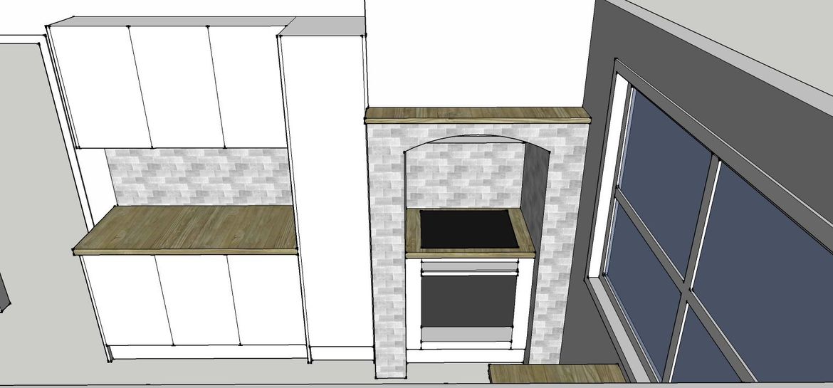

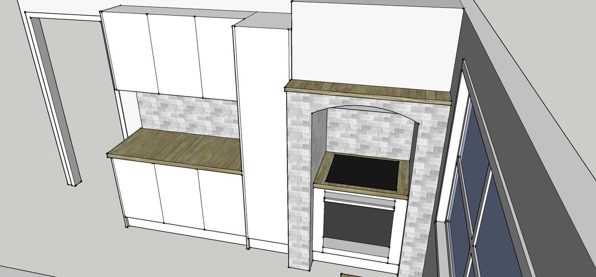

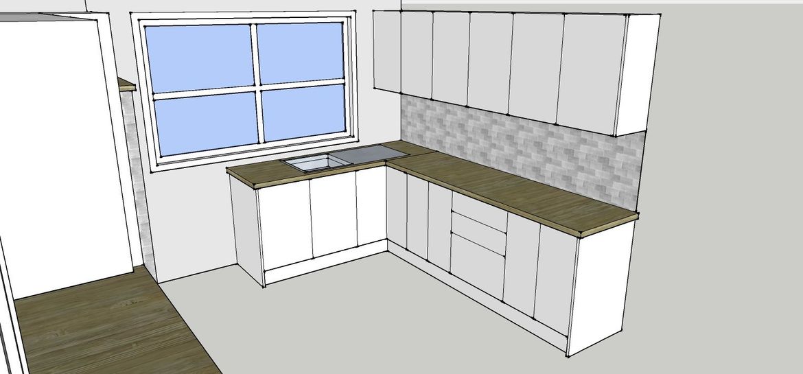

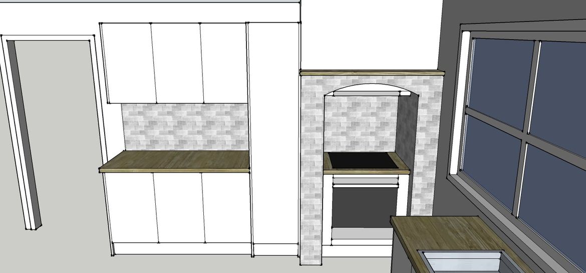

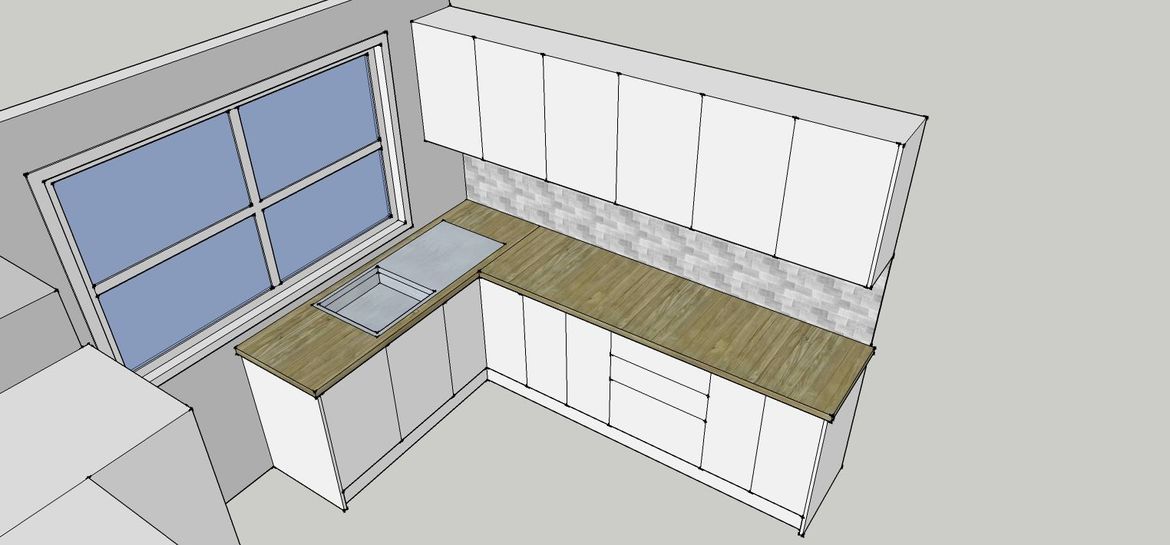

I've done a rough calculation with your budget in mind :
5,500 kitchen cabinets, doors, hinges, handles, kickboards and benchtops ( Gloss white doors, laminated bench tops )
320 for your vinyl floor
99 sink
99 tap
190 for 2 cans of 15ltr paint
240 for 6 cartons of tiles
80 for 2 bags of tile glue
23 tile grout
100 new lights
50 new power points
500 for the electrician
500 for the plumber
2000 for the kitchen installer / flooring / tiling / painting
180 delivery
Estimated total of : $9,881  ( round it off to 10,000 for miscelaneous items, silicone, nails, KFC etc... )
Estimated turn around 2 weeks if the gods align the planets and there are no delays.
Oh I did forget something! The appliance pack oven and cooktop! Add on about $800 for a ceramic cooktop and oven package.
Here's some purty drawings!

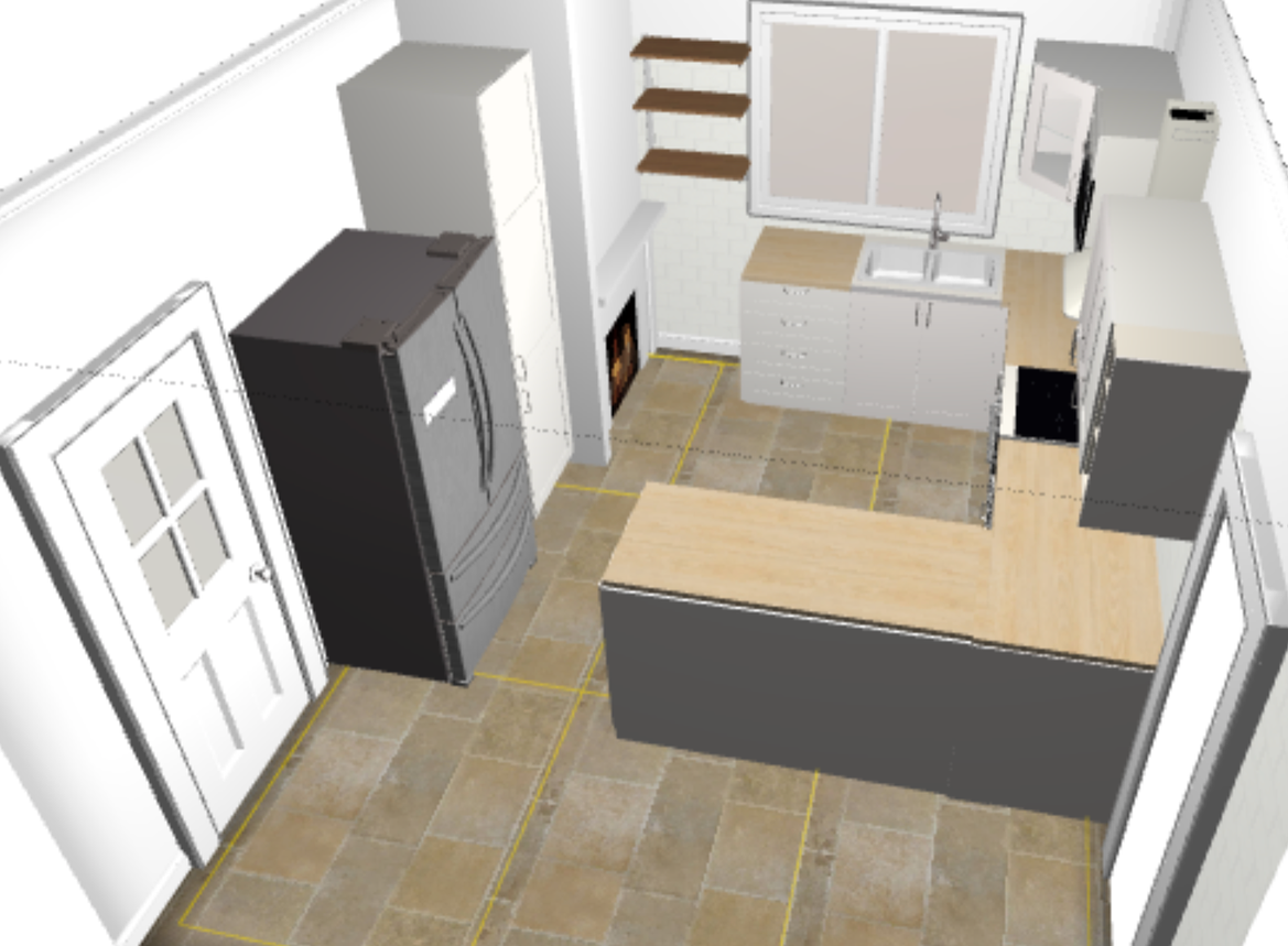

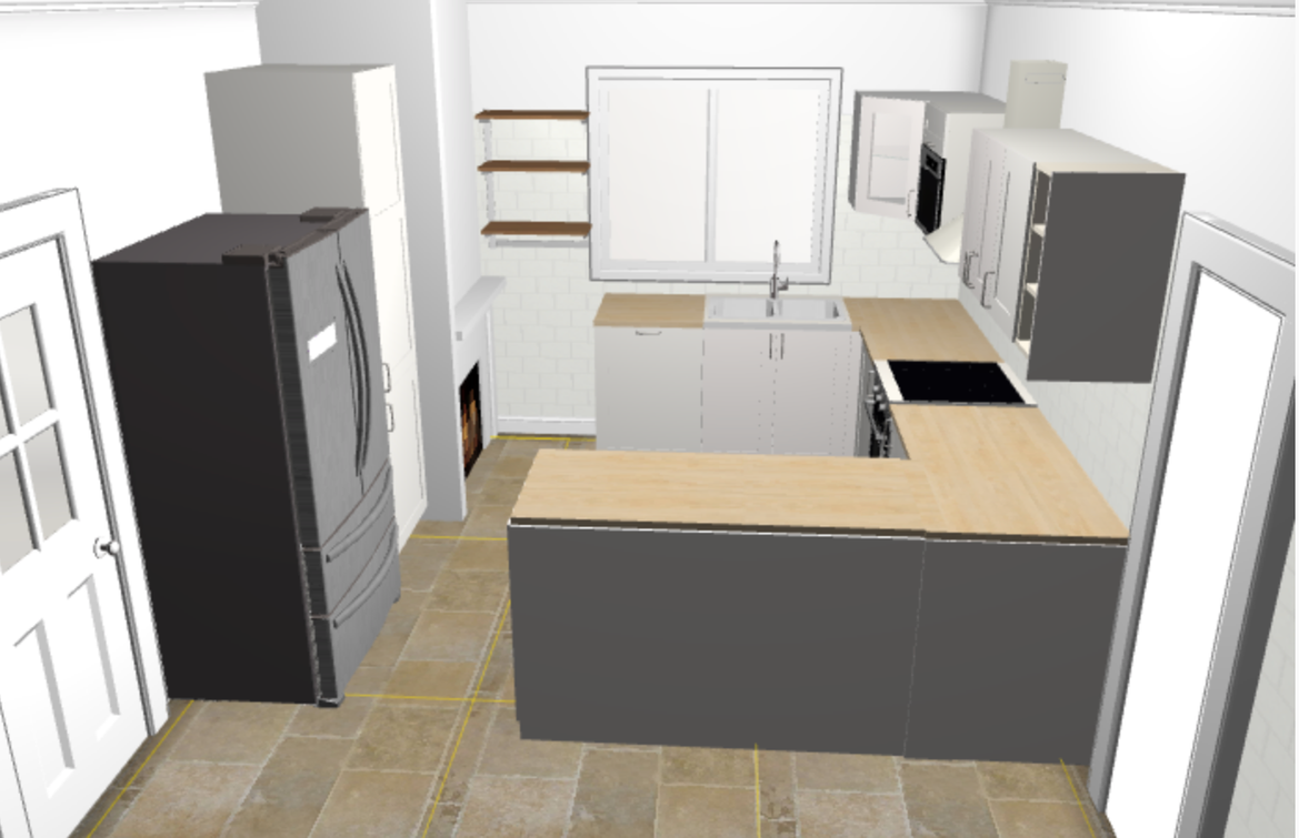

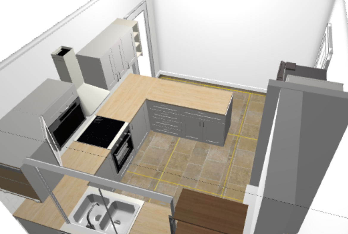

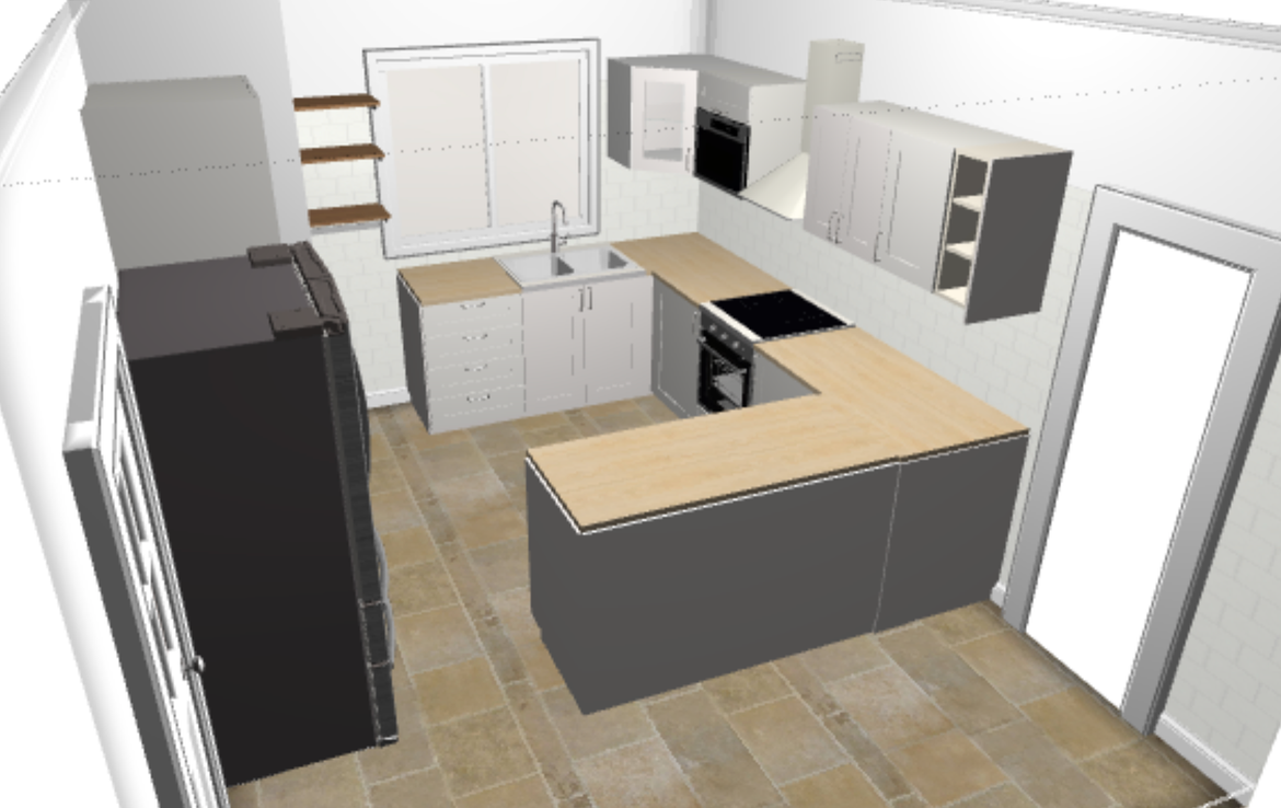

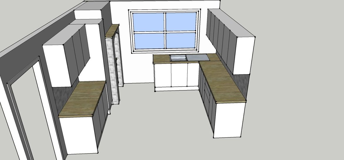

Well I was inspired by @redracer01 to upload some pics of design suggestions.  The drawing is a little limited so imagine your fridge/freezer where the huge twin door fridge is, and your existing wood stove and mantle where the fireplace is.  Other than that, and having to guess the room dimensions, this is a real kitchen - all the parts, including stovetop, rangehood, oven, sink, mixer, microwave, worktops and all the cupboard parts and pieces (shelves, handles, hinges, a light in the corner cupboard) are included in the total which worked out to $7381.  *The cupboards are white, not grey as they appear but the image doesn't work with this.  What it doesn't include is splashbacks, wall paint/tiling and if you updated the floor or lighting. You would need to add the cost of installation (unless you un-flat pack it yourself which isn't too hard), plumbing and electrical work, and demolition/ removal of the old kitchen.  Personally I would keep the wood stove if it works; it becomes a luxurious addition when you have an electric oven and convection cooktop for everyday use.  Have you looked at what these things cost to buy/ install!? If your budget/ plumbing allows I would swap the drawers next to the sink for a dishwasher to take it to the next level (last pic). This is a functional, easy to use kitchen with all the critical elements in easy reach of each other.  I assumed that there was a door on the other side of the kitchen to the rest of the house.  An overhang on the benchtop and some breakfast bar chairs would also fit well in this design.
Something to think about.  Good luck with your renovation!
