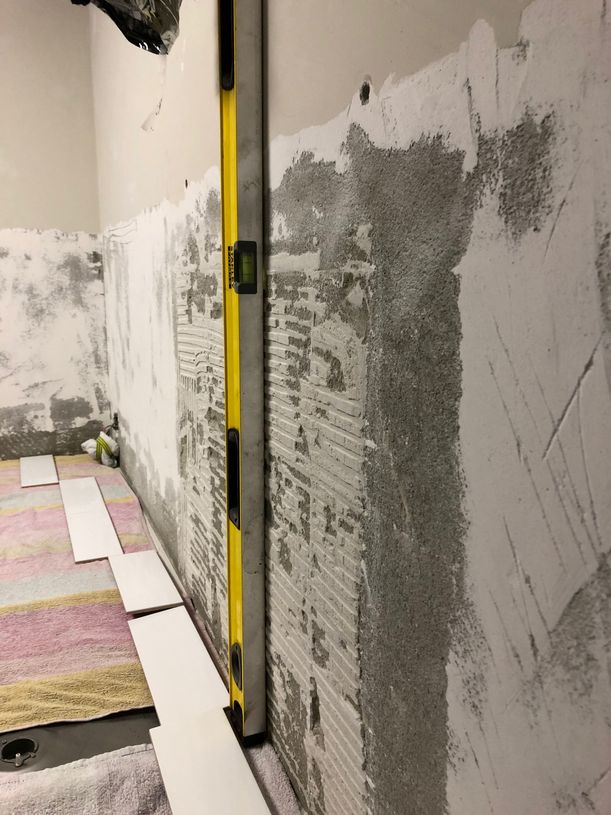

I have decided to retile the splash back of my kitchen. I have experience tiling with a mate for a few days and then doing the job to a number of previous houses; so the tools and skills I am OK with. However the substrate is the one that is a bit different so I want to check here.
Some of the area (see the picture) was tiled and some was painted. After some research I believe that tiling over paint is asking for trouble so I have stripped it back (with a 40 grit belt sander...very carthartic
) to mostly float coat/render coat (the grey stuff). I also was left with the impression that 'white set' was fine to tile over as well...as long as all surfaces are cleaned AND WATERED prior to starting the job. A few queries I would appreciate a word on:
1. i intend to do a 'skim coat' (proabably wrong thing to call it sorry) of tile glue with the flat side of my notched trowel - reasonably thin 3-5mm max - to make sure some of the divots of render that came out are filled and to give the wall a flat surface to then tile on. I did it this way with my mate and also have read that it is an OK approach...does anyone see any problem with that? Obvious reason is I have a big bag of tile adhesive and no other tiling jobs...so I may as well use it here.
2. The picture shows some existing tile glue that was part of the previous splashback (above the stove top). I have chipped off the pieces that were too proud to allow an even 'skim coat'; however should I take it all off (back to the render) or is it OK to put new tile glue over existing?
3. Do I need to prime this surface? This one has confused me as manufacturers (Davco etc.) say that all surfaces should all be primed...yet a forum I read said that if you are at the float coat/white set stage and you prime the surface it can react with the tile glue and become a gluggy mess resulting in your tiles sliding down the wall.
4. On the tile adhesive I bought UltraFlex from Funnings as I believe it was what I used before (it has been a while so I'm probably wrong); but the Davco website is telling me Mastic is what I should be using. Easy enough to change over if there is an appreciable difference.

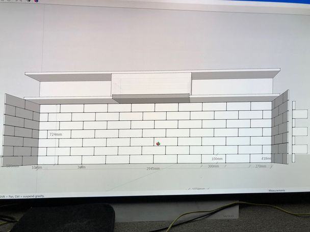

My intended methodology is to clean the dust off of the wall, give it a wipe off, give it a light spray of water (as the render has been there 2.5-ish years it would suck all the water out of the tile adhesive otherwise), do the skim coat (of tile glue NOT render) to provide a flat surface, then proceed with double checking my set out and tiling like normal. Tiles are 300x100 with a 3mm spacing. 7 rows high across the rear wall and 600ish down the return walls. Actually I will include a CAD plan I did of the tiling...it is rough and includes the eventural rangehood and shelves that will follow on from the tiling so I hope it is not too confusing. I have put a level (I think I have a laser somewhere but I can't find it!) and a straight edge around all the walls and planned it all out...I am pretty comfortable with that; it is just the substrate that I am concerned about.

The CaptainThis photo is taken from roughly the same viewpoint as the CAD drawing photo has been
Closer look at the render and white set and tile glue section

G'day @Former Workshop member . Seems very scary at times but it's pretty simple.
Firstly I would recommend getting the old glue and white set off. As the new glue dries under the tiles it can tend to pull off the existing white set or glue.
Once you have got as much off as possible then definitely prime your surface. The only time primer will go a white gluggy mess is if you start tiling when the primer is still wet..
Priming over a dusty surface is essential.
Doing a skin coat of glue is a good idea to get the surfaces flat.
What we used to do is work out the deepest spots circle them, notch trowel the area and with a level screed the glue flat then steel float it with the back of your notch trowel.
Then allow the glue 12-24 hours drying time before tiling.
As to set out. The best way is to find centre. Then step out with your tile from either the edge of your tile or centre of your tile and see what cut works best.
If you have measured centre you only have to step out either left or right, not both as the centre measurement with give you equal cuts if that makes any sense.

@gippslandhome wrote:G'day @Former Workshop member . Seems very scary at times but it's pretty simple.
No problem getting the white set off - I think I mentioned I used a belt sander (not sure that it is the right tool for the job)...? Whether or not; it made mince meat of the paint, white set and render (use a vacuum cleaner attachment; trust me). I used an Ozito 20 litre wet/dry vacuum (yes they're cheap but work well for mine *shrug*) but my kitchen still looked like a set from ScarFace...just intended as light humour but understood and apologies if that gets admin blocked
The tile glue though...well I will certainly defer to your expertise and remove what is there 👍
My concern with the existing tile glue was more whether a NEW tile adhesive would stick to the OLD tile adhesive. The existing tile glue is stuck to the float set like 'superglue' so I figured it would suffice as a pretty solid substrate. No problem though - it's great having the big green one stop shop less than a 90 second drive away! - so I'll get a bolster and probably a gimpy as well. EDIT: I believe Bunnings call them 'club hammers' to avoid possible offense - certainly none intended by me - that's just what they were always called on site.
@gippslandhome wrote:Once you have got as much off as possible then definitely prime your surface. The only time primer will go a white gluggy mess is if you start tiling when the primer is still wet..
