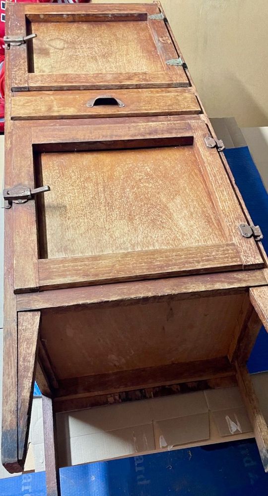

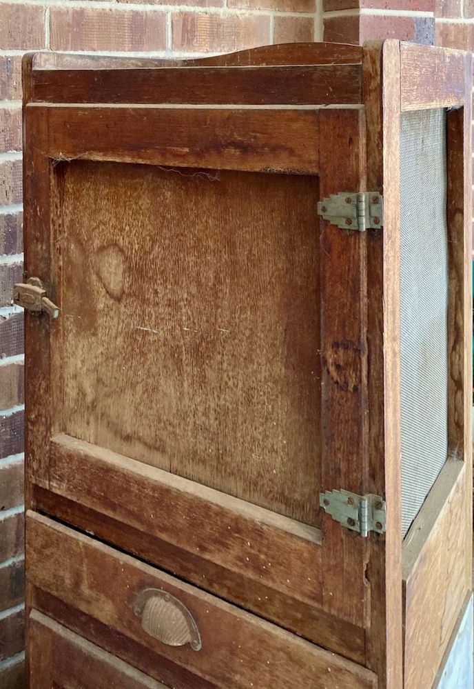

This pantry belonged to my grandmother and was purchased in the 1930s.
It had fallen into complete disrepair when I recovered it from my mum's garage.

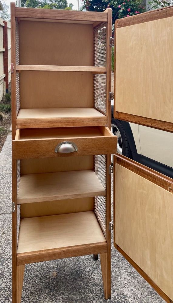

Inside the cabinet

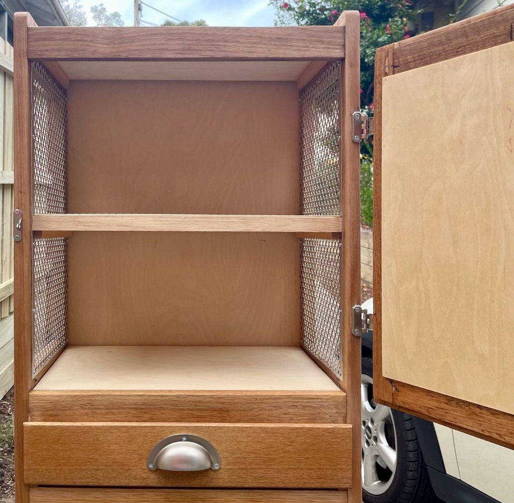

Front three-quarter angle

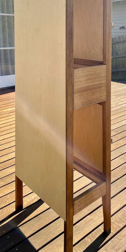

Top of cabinet

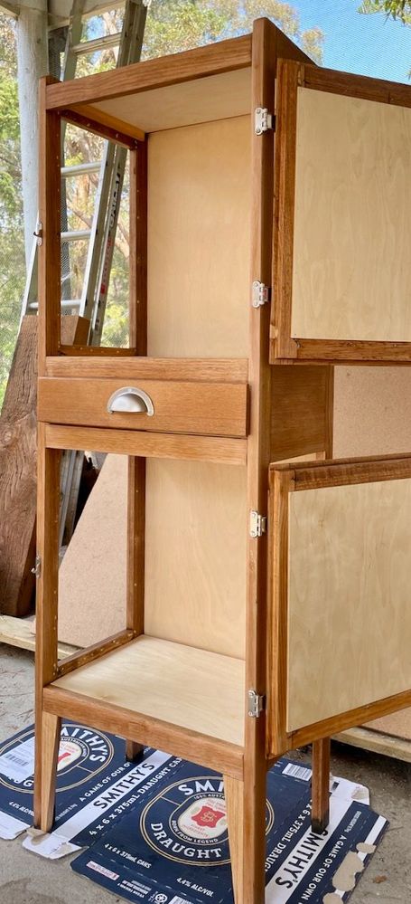

Perforated metal at right hand side

The first step was to dust off the cabinet and do a basic clean up to see what could be salvaged and what needed to be replaced.

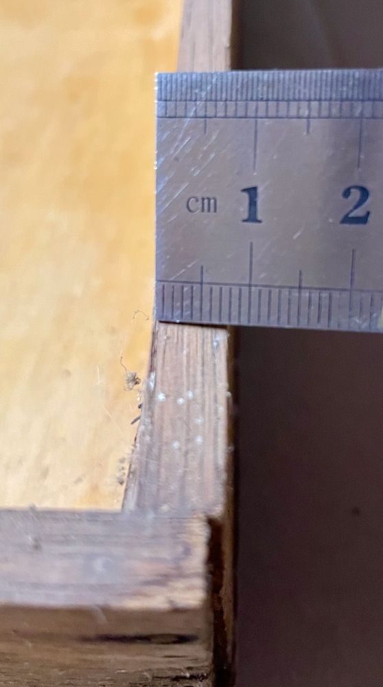

When removing parts, my goal was to replace them with items that were as near the same, so careful measurements were taken.

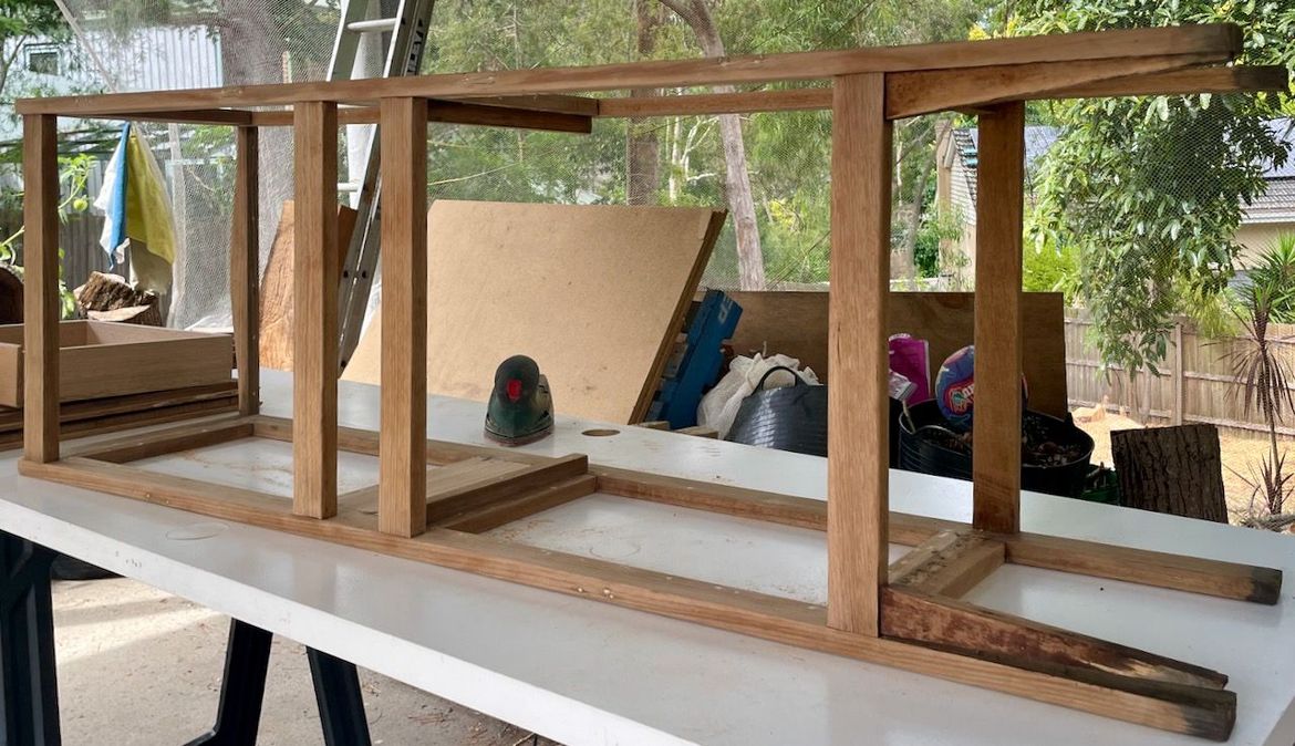

Ultimately it was necessary to strip the cabinet right back to its frame. At some point my grandfather had re-nailed the perforated metal using bootmaker's tacks, which were incredibly hard to remove!

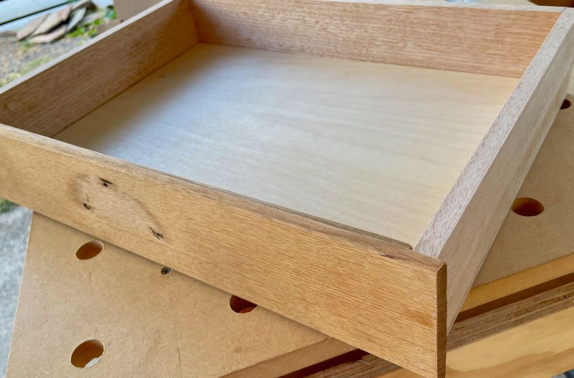

I remade the drawer, with the only original item remaining being the fascia board.
Three coats of hard wax oil were applied and the new handle was fixed into place.
Step 6
After a massive amount of sanding to bring back the original timber, I cut and attached new 3mm plywood panels to the frame.

Three coats of hard wax oil went onto the reassembled cabinet and new hinges and latches were attached.
Step 8

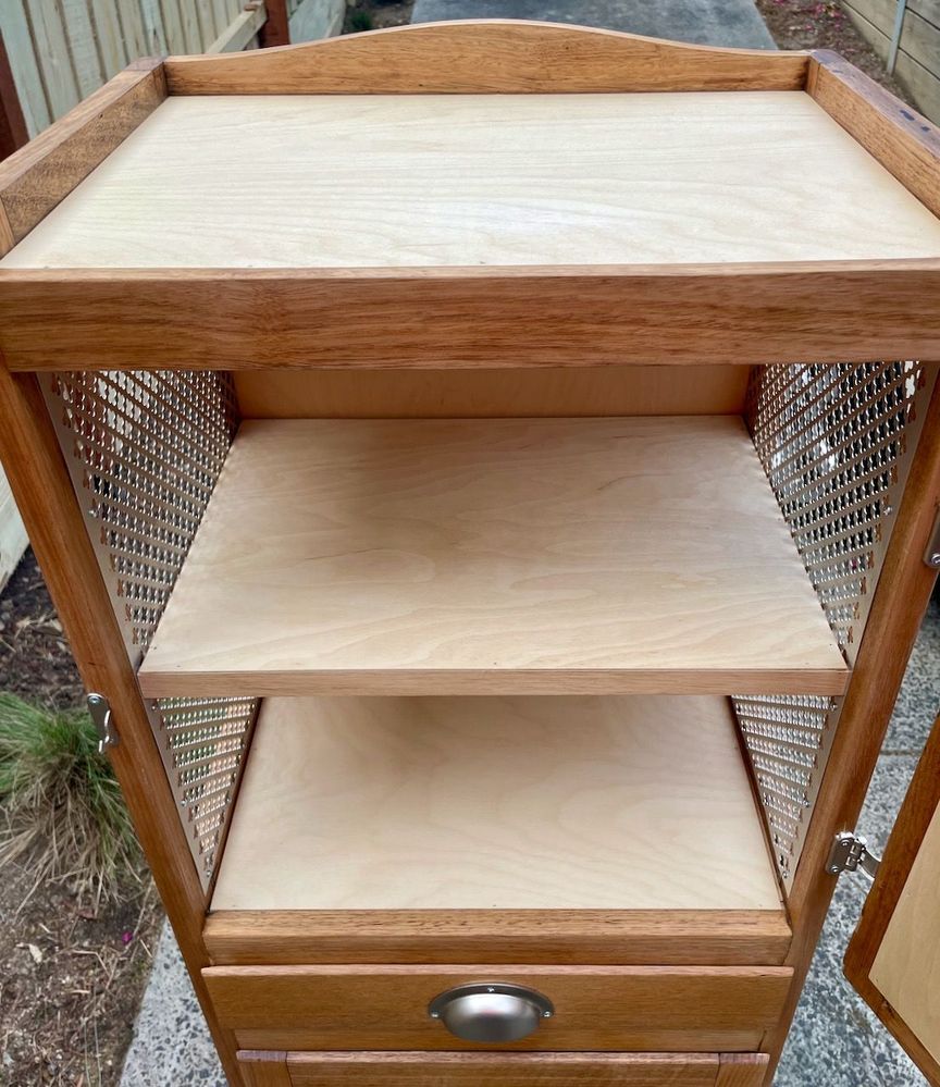

Then it was time to cut and fix the new perforated metal. Note: this had to be completed before the top and bottom internal shelves could be put back into place.
Step 9
The final step was to fix the internal shelves back into place.
Step 10
And so it was, we went from this ...
... to this:
