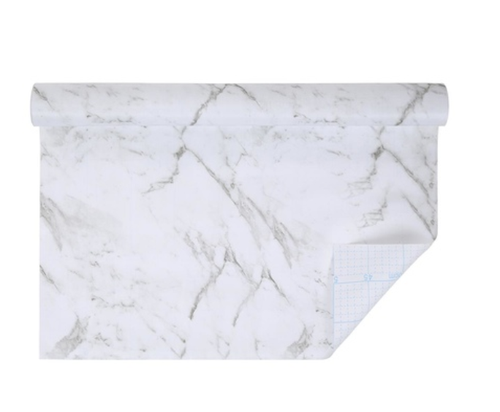

Reaching out to you for suggestion on 'vinyl adhesive roll' (Figure 1) on Kitchen tiles.
Figure 1:
Figure 1Figure 1

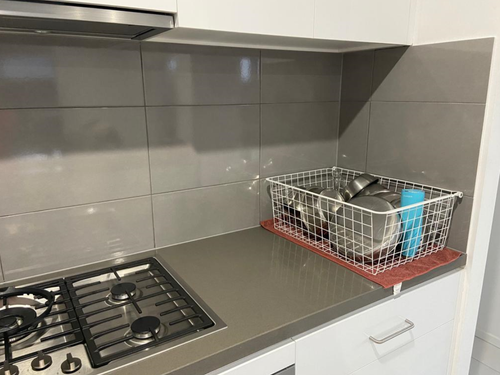

'Figure 2' shows area of 'Wall tiles' where above vinyl adhesive rolls are to be applied.
Figure 2:
I tried to stick 'vinyl adhesive roll' on Kitchen tiles. Observed 'Airbubbles' at some spots when applying 'vinyl roll' to tiles.
Looking for ways to apply 'vinyl roll' to Kitchen wall tiles perfectly without any airbubble. Are there any tools available from bunnings for the application. Moreover, I need to cut out areas (for switches, powerpoints) on the roll; Can you please propose any tools [ Is a knife sufficient (or) better tool is available] for cutting needs.

Vinyl is notoriously hard to apply without getting any air bubbles. I believe the parents around Australia can attest to this at the start of every school year whilst trying to apply it to their children's textbooks. I would recommend you start at one side and only pull the backing off as you are applying the vinyl. The use of a QEP 6 Tradesman Grout Squeegee will come in handy to push the bubbles out as you are laying down the vinyl. Any remaining bubbles you can come back and puncture with a pin to release the air.
A sharp utility knife would be your best option for cutting the vinyl.

I've noticed you have a gas burner. From a safety perspective, It maybe worthwhile considering how the vinyl may response to the heat and direct flame due to the proximity.
Depending on which state you are in, there are typically some regulations around material you can use in the area directly behind gas burners.

I’ve used vinyl contact for a few projects before and I find that it only really works if the area you are working on is perfectly smooth. I’m not sure how it would go on tiles as you would have air pockets where the grout is, so overtime it may lift up in the areas surrounding those air pockets.
Unless you cut the vinyl to the size of the tiles and avoid applying over the grout altogether? It would also be easier to apply as you can work in smaller sections.

We will consider other option of 'Wall art panels' in front of 'grey tiles'; That might consume 3 to 4mm space around the bench top; From safety (fire) point of view to explore more on using the 'Wall art panels'

I just wanted to let you know I've made contact with the supplier of our Wall Art panels. Unfortunately, they are not suitable for use anywhere near stovetops as they are not resistant to heat at all.
