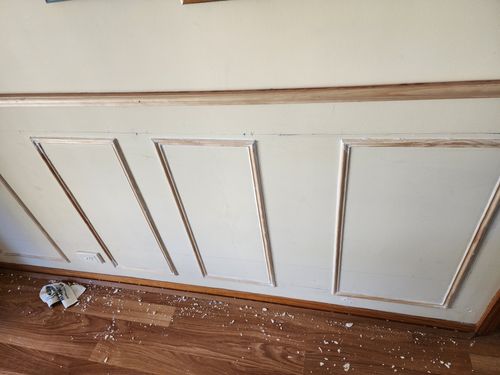

Step 1
Draw out the design
 Take all the photo frames above.
Cleaned walls.
Buy materials and paint from bunnings
Measure the bottom to fit and look evenly as possible.
Cut out the corners to size.
Glue them on wall, use nails.
Fill gaps with Rapid.
Paint upper wall with vintage white
Paint wall panels and lower wall with light green.

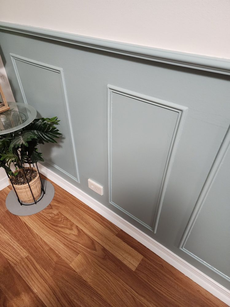

Re: wall designed panels
Hello @Susana78
Welcome to the Bunnings Workshop community. It's sensational to have you join us, and thanks for sharing your wainscoting project.
Your choice of timber moulding is perfect for the area not too big or small. Adding space to the design in order to integrate the power point was very clever. Overall, an excellent wainscoting project that enhances the look and feel of the wall.
Again, thank you for sharing an excellent project.

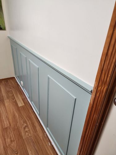

Hello @Susana78
Your choice of wall colour is very intriguing. Would you mind sharing the brand and name of the colour you used?
