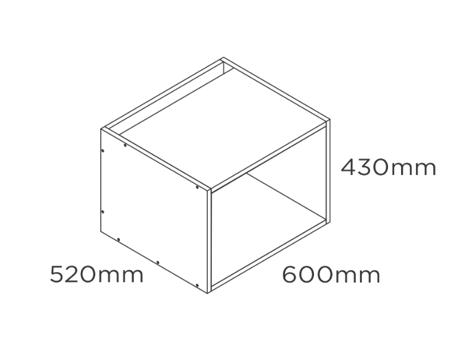

I'd like to know the internal dimensions of the oven and microwave cavities for the 600mm oven tower.

The microwave box external measurements are 520mm (d) x 600mm (w) x 430mm (h) the internal dimensions are 504mm (d) x 568 (w) x 398 (h).

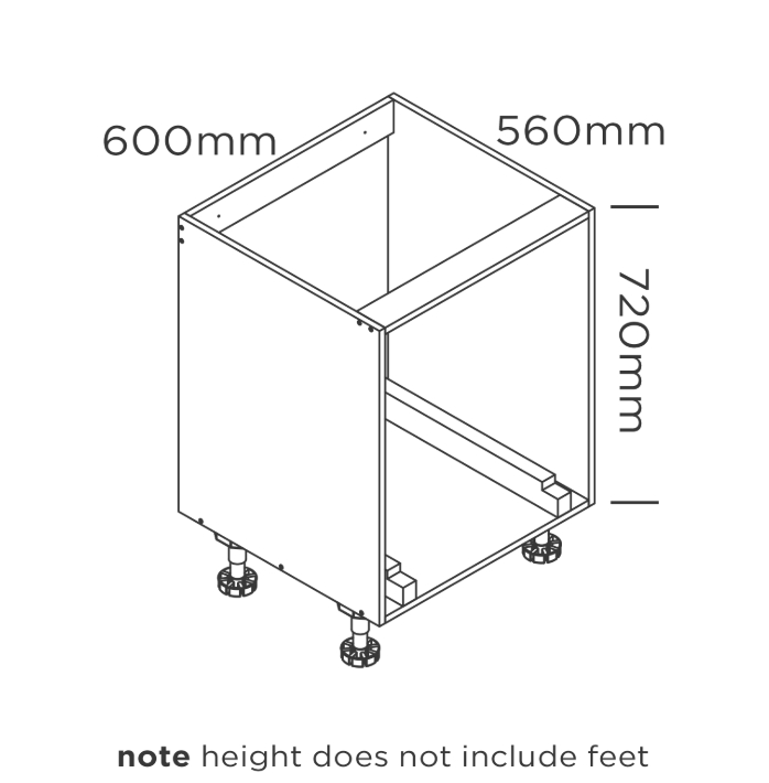

In regards to the oven cabinet the external measurements are 560mm (d) x 600mm (w) x 720 (h) (legs not included). The internal measurements are 504 (d) x 568mm (w) x 688 (h).
Please note that when looking at your appliances it's important that you get the actual appliance measurements not the external dimensions.

The oven cabinet is 685mm high, 600mm wide and 580mm deep
The microwave cabinet is 398mm high, 568mm wide and 504mm deep.
