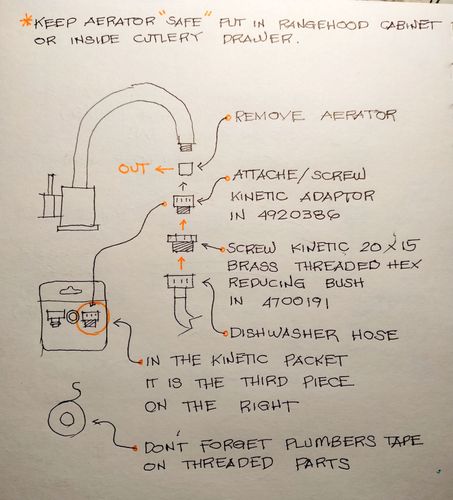

Here is a suggested diagram for you when connecting the dish washer to the sink tap. Hope it helps.
Cheers.
Red

Thank you that will be a great help
