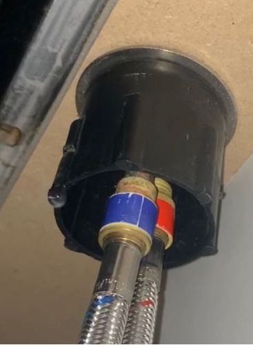

Im looking to remove fixing nut inorder to replace my kitchen mixer tap. My hands barely reach behind the sink. Im not sure what tool can be used to remove this fixing nut( black)
Hi @clivelloyd
Unfortunately, there is no specific tool to remove this plastic fixing nut under the kitchen tap. This type of assembly is usually installed before the sink is fixed in place. In order to have better access to the fixing nut, I suggest removing both Flexi-hoses by turning them anti-clockwise. Once the hoses are off you should have a bit more access to the fixing nut.
I recommend using Haron 45mm Slip Joint Pliers. If the black plastic skirt is too flexible and you cant get a grip on both sides try holding just one side to get it loose. If it still proves to be too difficult, you'll have to remove the locking clips under your sink and take your sink off in order to remove the kitchen tap.
Thanks Eric
Let us know how you go @clivelloyd and don't hesitate to reach out again if you continue to have difficulties. We're here to help.

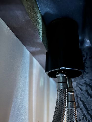

Would this be the same?
Welcome to the Bunnings Workshop community @domhaywood. It's wonderful to have you join us, and many thanks for your question about tap nuts.That is the same nut as shown above. This basin wrench wasn't mentioned previously, but it can often allow you to remove nuts in difficult-to-reach spaces. The head flips over, and the turning is actioned by the T-handle.Please let me know if you have any questions.Mitchell
