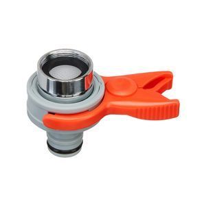

The next picture is the Pope Indoor Tap Adaptor which is used to attach your garden hose to a regular sink or laundry tap with an aerator. This adapter uses an M22 and M24 fitting.
To make it easier when choosing garden fittings, if you have the old fitting, I suggest bringing it with you to the shop to make sure that it is the same size. If you need a particular plumbing fitting, I recommend investing in a Craftright 150mm Digital Caliper. This will guarantee that you'll be getting the correct size all the time.
