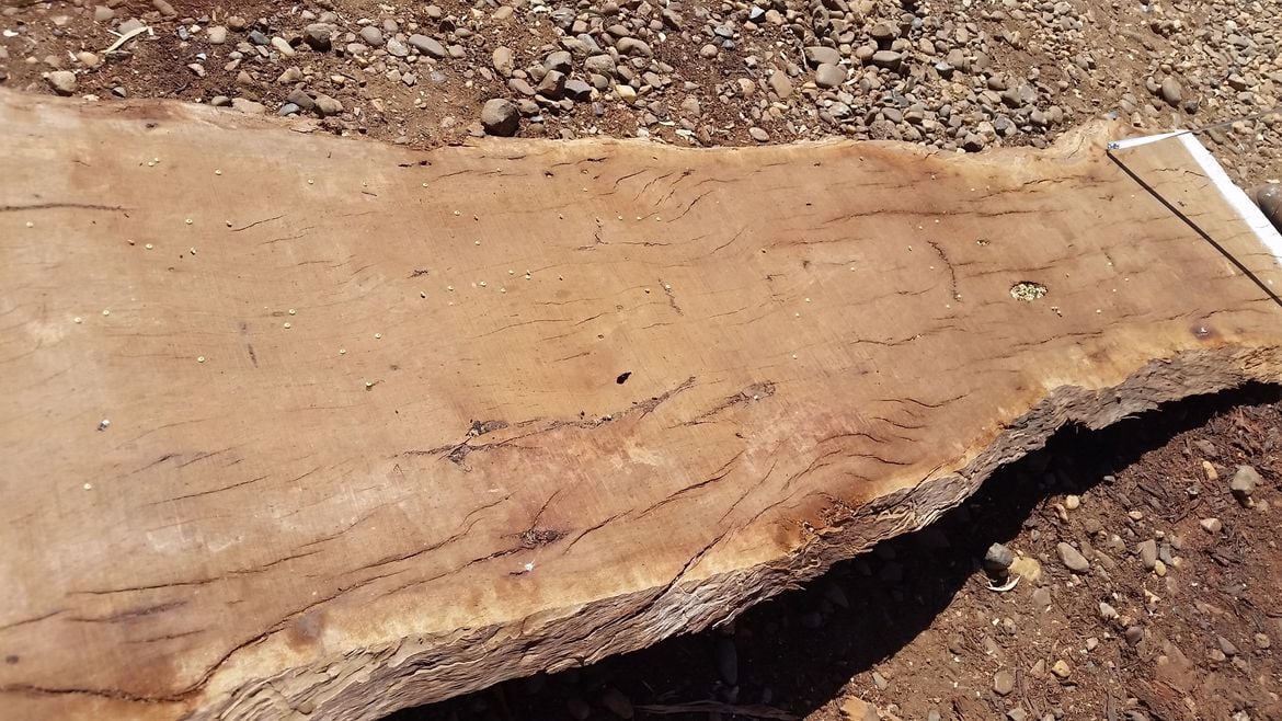

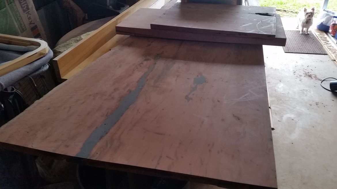

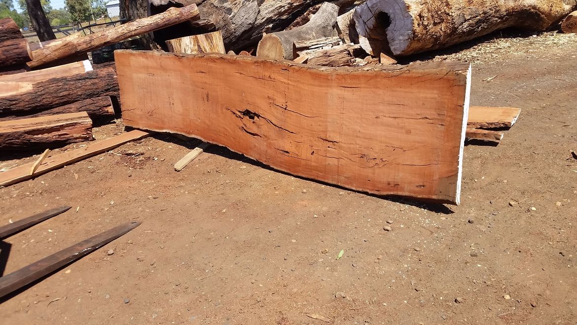

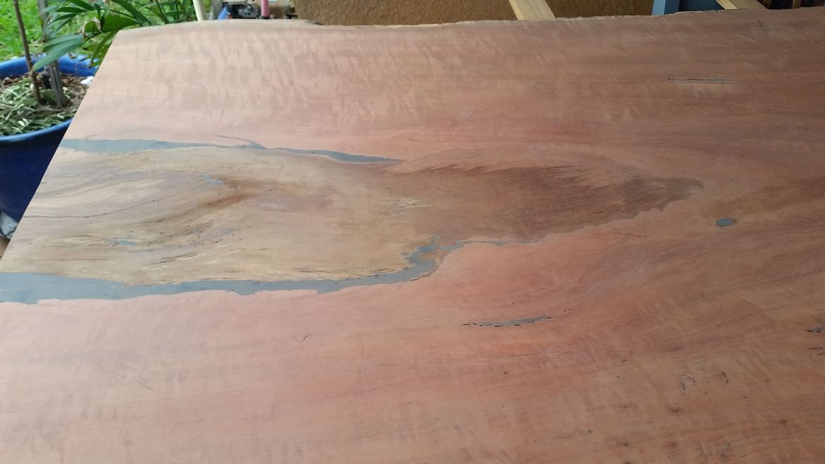

20191205_103716.jpg20191205_103931.jpg20191205_111201.jpgHello folks,

I finally found my slabs of timber late last year and in the process of having them sanded back ready to dress ? do I Resin, oil or varnish, I haven't decided on that one just yet !  *(yes slack of me, need more research)  But will get there.

@Old-gal24 In regards to your question about the live edge slabs, it may be answered by if there are any voids in the timber. So if there are knots and voids you may need to use a resin to fill these if you want a smooth finish. If there are no voids then an oil or polish is an option. Varnish is great but can easily scratch, if you are to varnish make sure you get something designed for bench tops. Even then I have been dissapointed with a particular water based product which left a lovely finish, but was not durable in the slightest (not saying that is all water-based top coats though).
I haven't personally tried this (though I have some experiences with resins, especially trying to fix mistakes) but take a look at watson glass finish it's still a two part system, though it should contain equal part bottles you just mix together. Any mistake i've made with resins have come down to how much catalyst i've put in, this product will take the guess work out of it.
