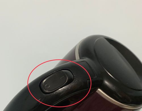

My kettle fell accidentally, so I need to replace a new switch now, but I don't know where to find it.

Yes I agree with JDE...The switch is an integral part of the handle and difficult to replace if not impossible..
I'm afraid it's a new kettle..
Like everything I break, with full intentions of buying new ones. I pull it apart to see how it works, I'm sure it's just a rocker switch underneath. Check out jaycar. They'll probably have something there. But including the time taken to do all this, it could cost as much or more than getting a new kettle.

Here's a thought..If you're able to turn the switch on and off...mechanically speaking, then it might be something else internally like a broken element or disconnected wire..or just some dirt lodged onto the contacts..
It's pretty difficult to break a switch like that internally and the outside looks fine..
Try spraying the switch through any opening with some WD40 or the like using the small tube that comes with the spray can..
That might be all it is...
The bigger problem is @wuxuan being able to access that small area in the handle. You could spend that extra money buying the switch or even finding someone to repair it for you, only to take it home and that's not what the issue was in the first place. Also the safety of yourself and others is more important.
