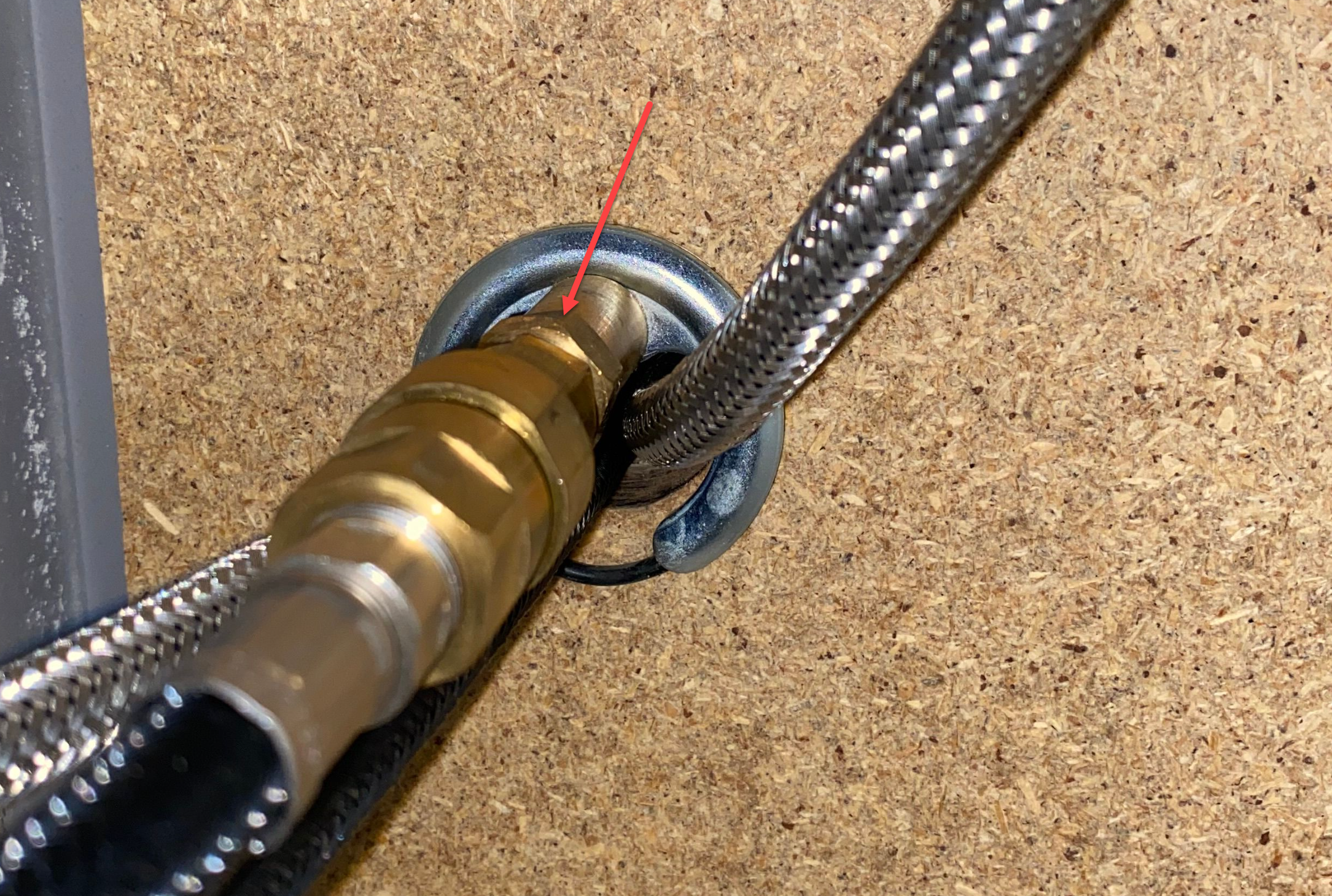

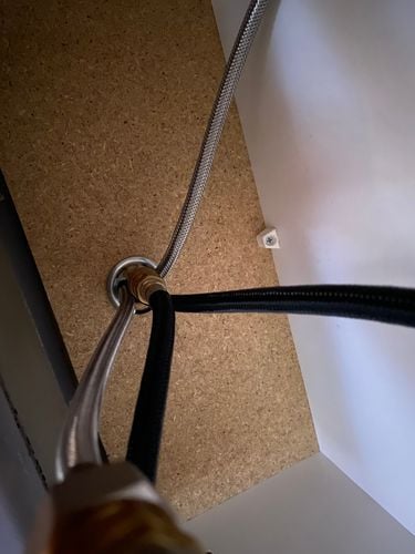

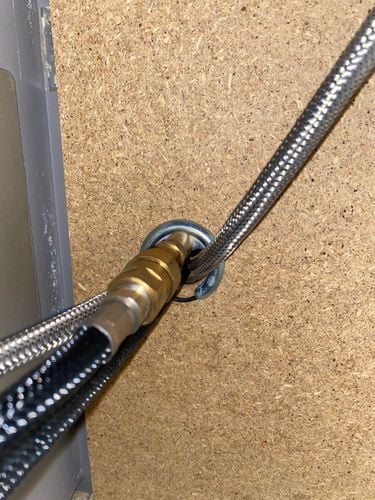

Hi,  just wanting advice in how to tighten a abey loose mixer tap.  The connection inside the cupboard isnt the same as I have seen in other posts (there isnt access to the screws that connect the tap to the sink) so I’m
not sure how to fix this.  Any insight most appreciated. Thanks
Re: how to fix a loose mixer tap
Hi @sarahh354,
I'd agree that this fixing setup looks a bit different to most mixer taps that I've seen.
If you were aware of the specific model of mixer tap, we could check the installation instructions to confirm, but I suspect this nut here is what needs to be tightened.
You should be able to tighten it up with an adjustable wrench.
Give this a try and let me know how you go. Happy to help further if this is not the answer.
Thanks Jacob,  I did give that a go and it worked.  Thanks for the advice
