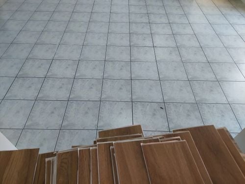

We also did the floor preparation to ensure the adhesive planks stuck on well.
Before

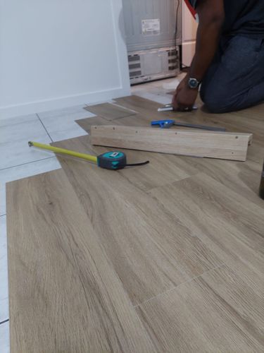

Process
There was a fair bit of planning to do (self driven) to ensure everything looked just right and extra care to execute but the results are worthwhile.

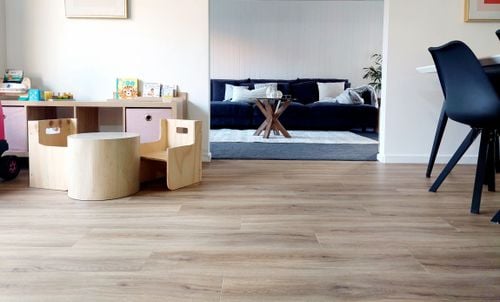

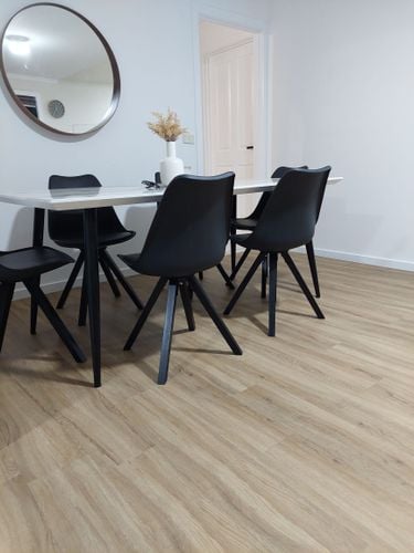

Dining area
We started with the dining room and the kids area - a good large space to get used to and the  continued to the kitchen area.

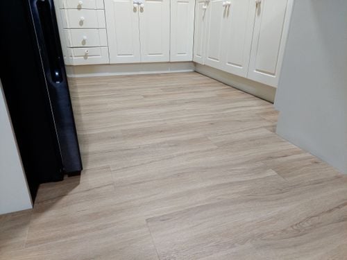

Kitchen area

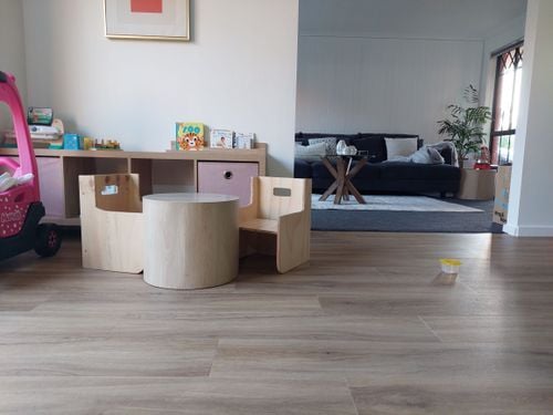

Kids hangout
