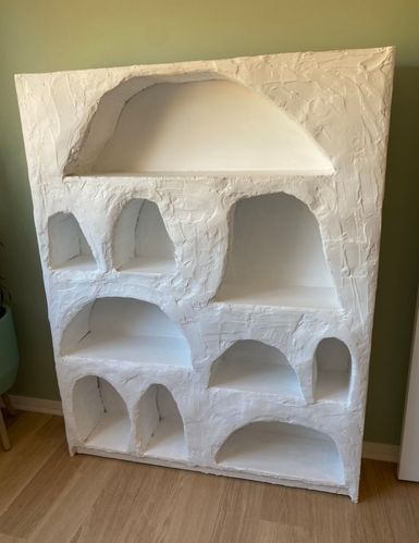

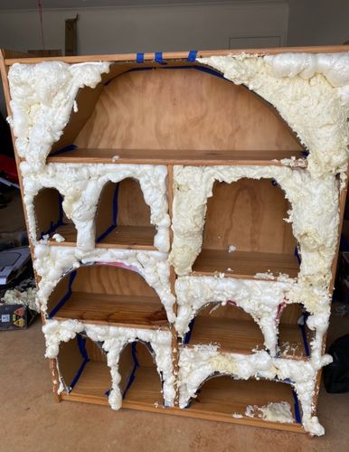

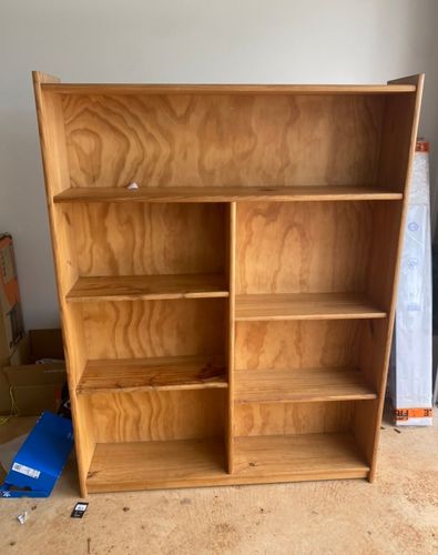

I upcycled this basic old pine bookshelf into a beautiful, on trend retail shelf for my hair salon. • I started by taping cardboard to the shelf to create different shape arches. • I used expanding foam in the gaps I wanted to fill the shelf in. • When hardened. I smoothed out the expanding foam using a hand saw to be flush with the bookshelf. • I used cornice adhesive (plaster) to cover the bookshelf. I used a trowel to apply and smooth. • When it was dry I used a hand sander to smooth out the plaster. • Primed the inside of the arches. • Painted the bookshelf in Dulux “vivid white.”

I absolutely love it; the Mediterranean vibes are just the best! The organic shapes of the carved areas are so neat. Do you have plans to do anymore? I think a smaller wall-hanging version would compliment it well.
You've done a spectacular job, and I trust you are delighted with the results. I look forward to seeing what project you tackle next.Mitchell

Wow that's really cool.
All I saw was the cardboard and thought oh dear that looks a bit unfinished ha-ha
It looks fabulous, well done.
