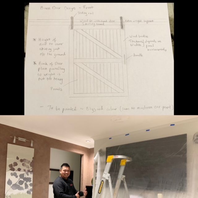

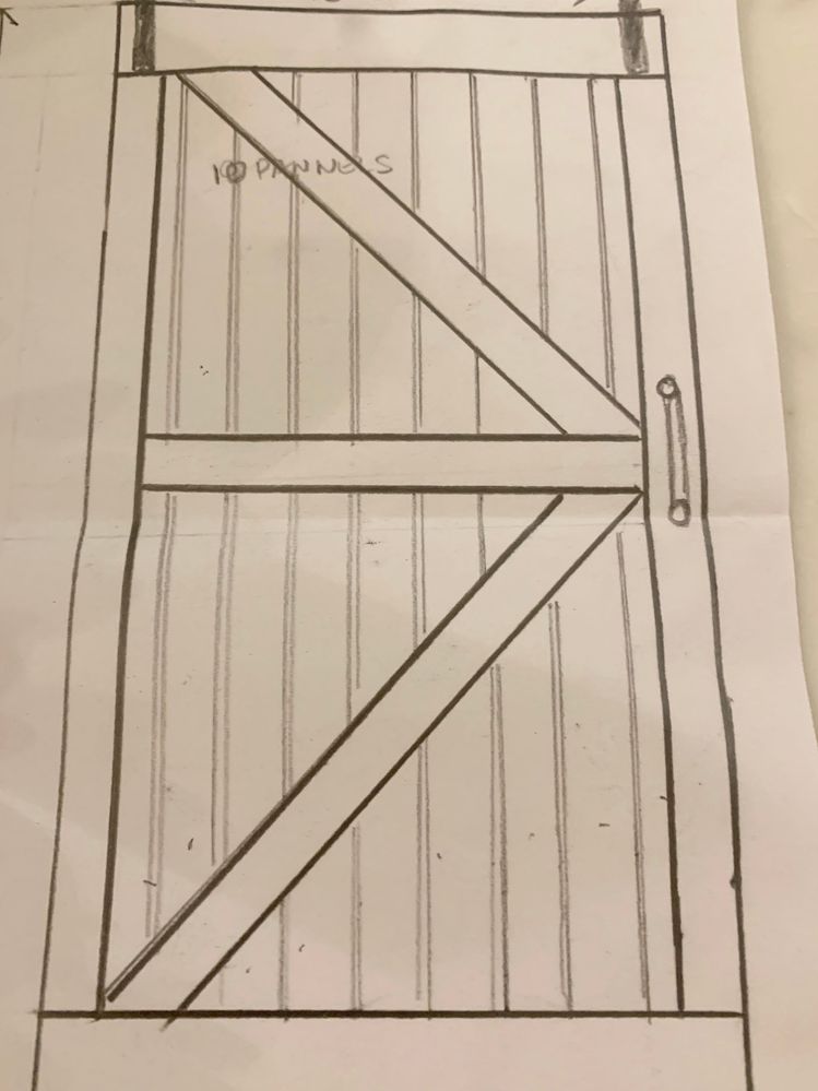

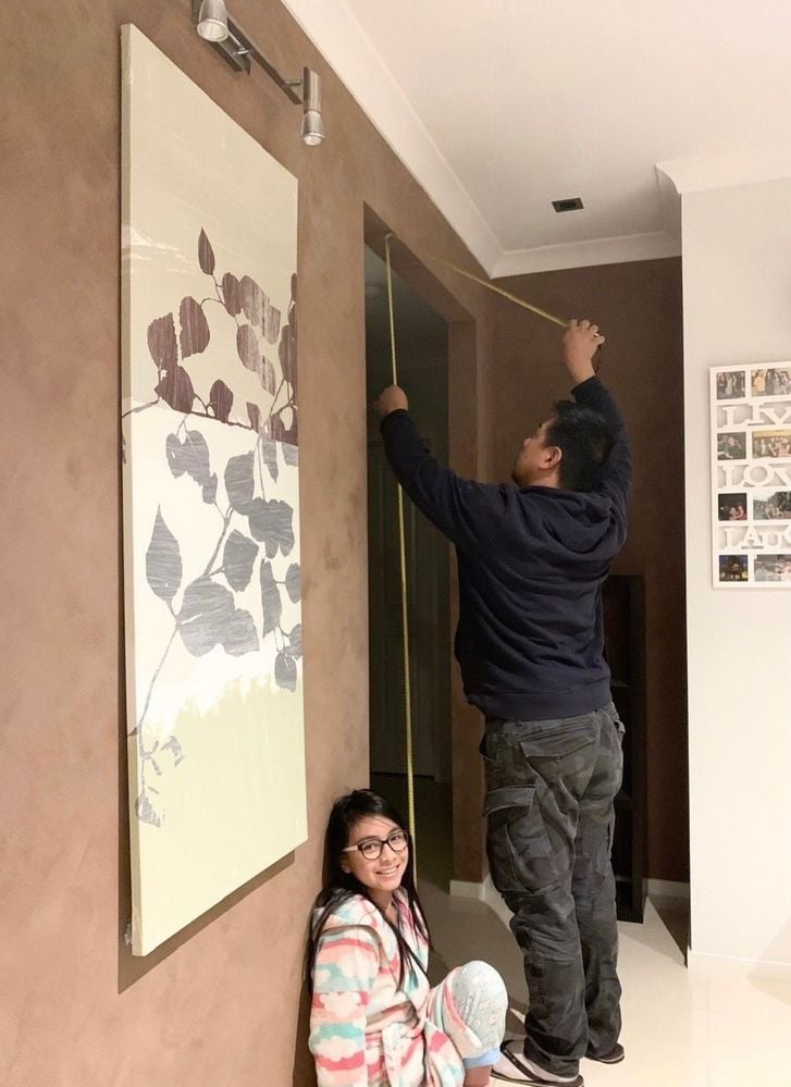

1. Planning & Designing
- Measured requirements for our barn door.
- Sketched designs.

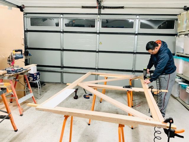

Step 2

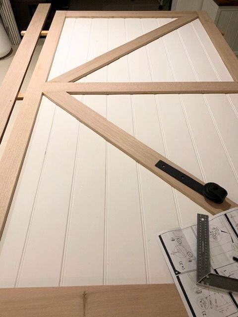

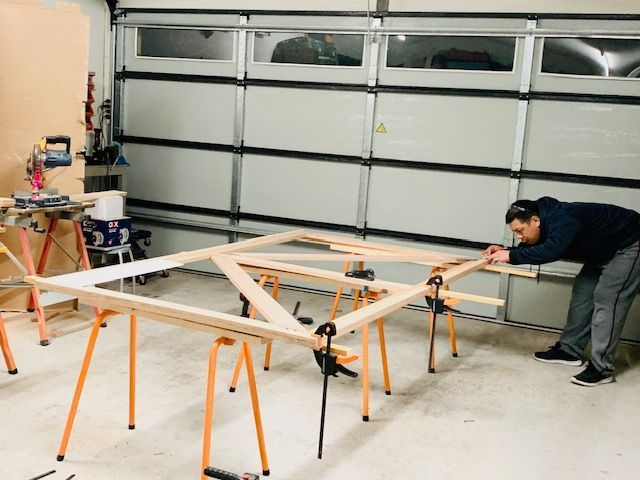

2. Materials & Construction

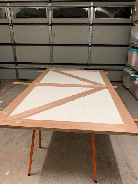

- Gathered all materials and tools as per list above.

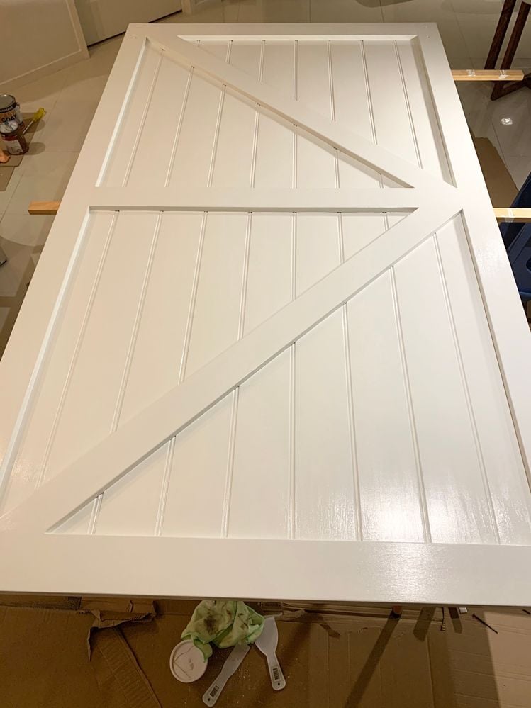

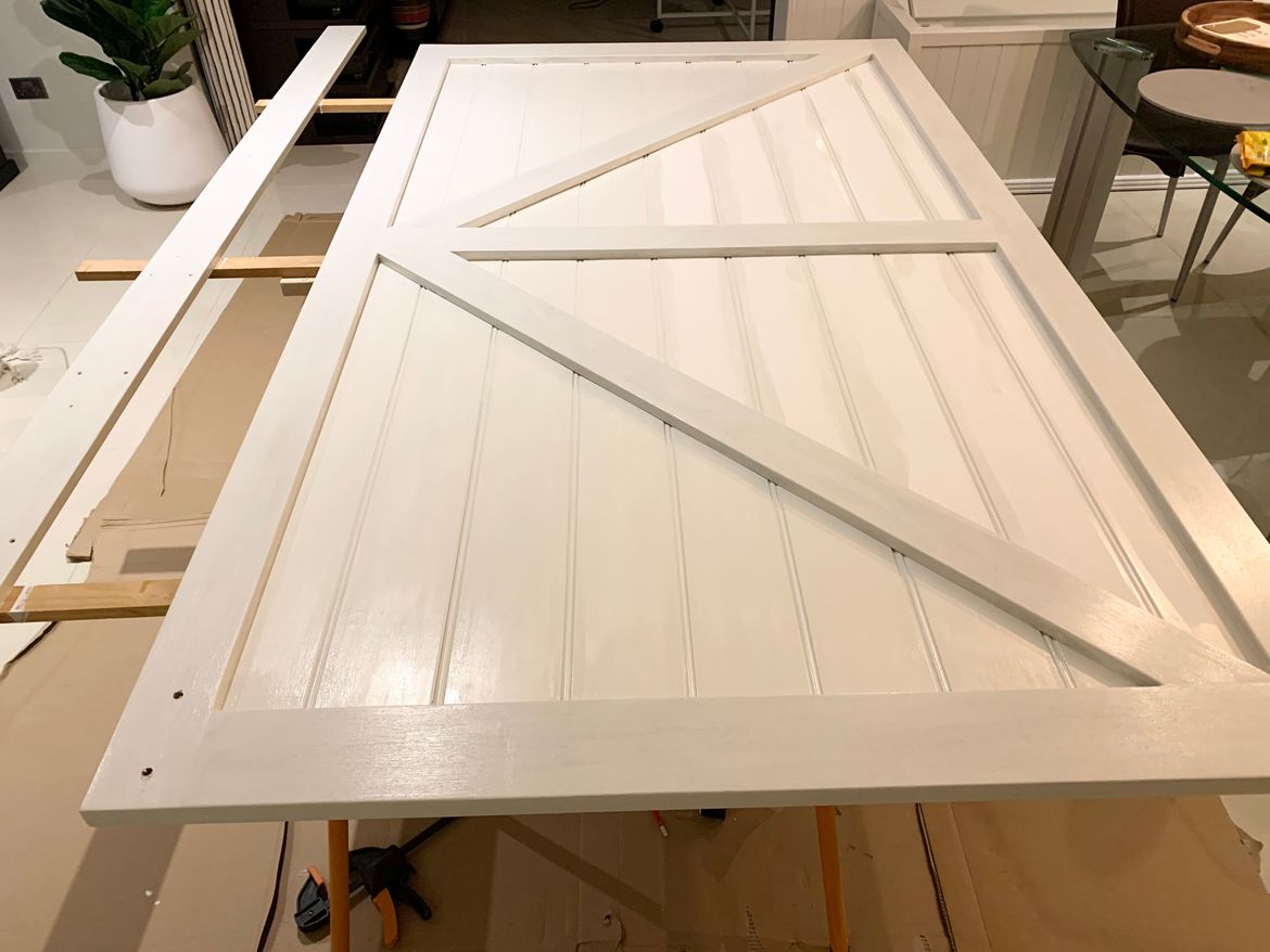

- Built frames and panels.
Step 3
3. Puttying and Sanding
- Putty added to areas of where nails can be seen and to smooth out any imperfections of the wood.
- Gap filler also used for any noticeable bigger gaps in between panels.
- Sanded for a smoother finish in readiness to paint.

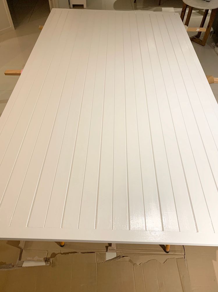

4. Painting
- Painted door and roller rack guide with monarch paint brushes.

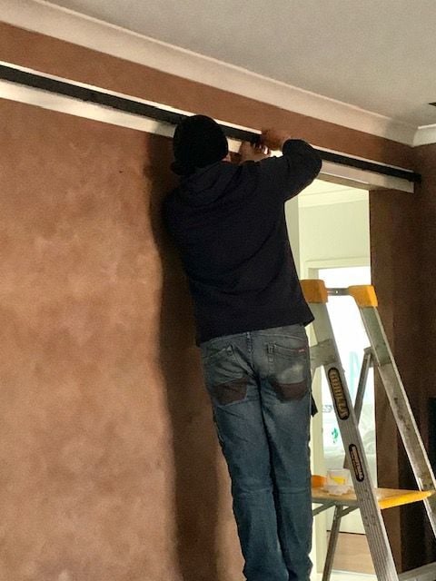

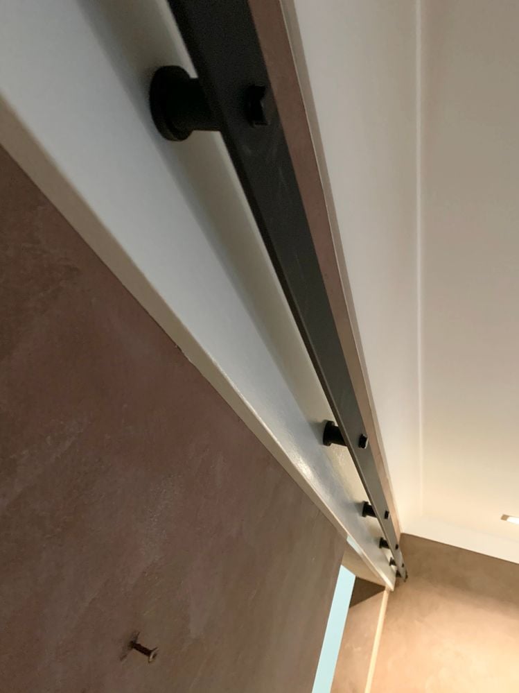

5. Roller Rack Installation
- Installed the wood panel for roller rack guide.
- Installed roller rack.

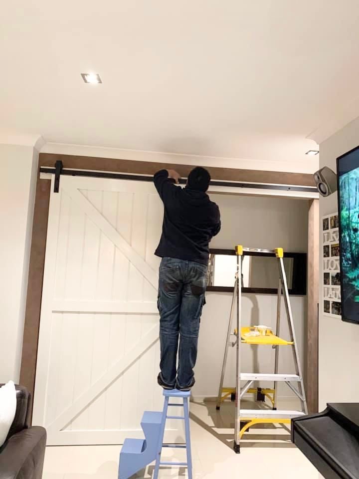

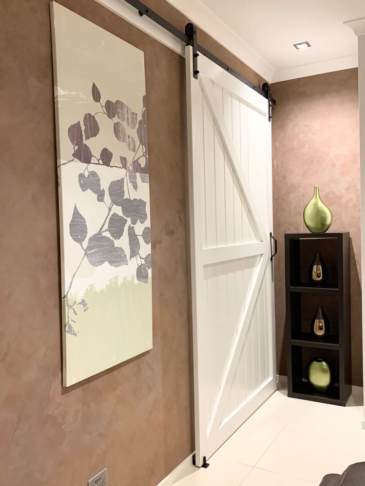

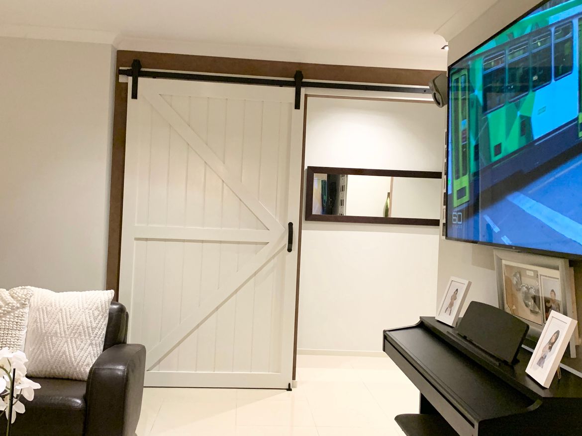

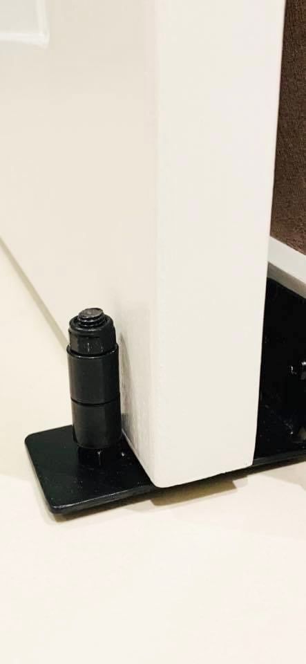

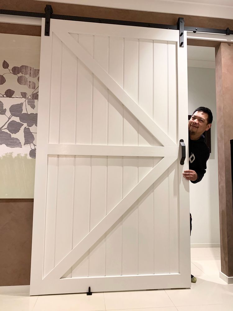

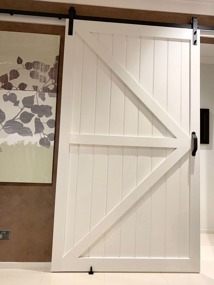

6. Installing Door and custom-made bottom rail guide
- Used the Move It Dolly to first lift the barn door into position to attach to roller rack.
- From extra materials, we were able to build a custom-made bottom rail guide so that the barn door can remain in position when sliding right and left.
- Barn door handles installed.

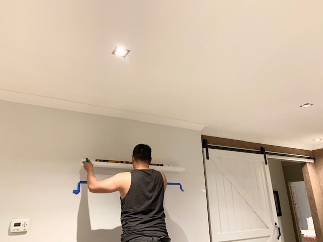

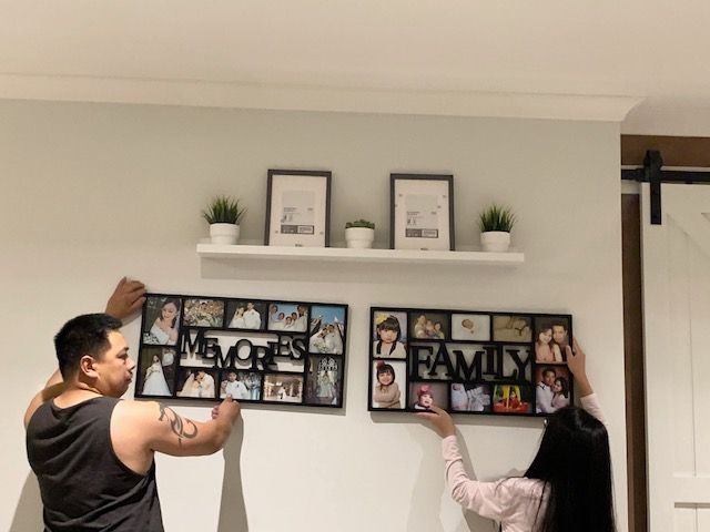

7. Floating wall shelf
- With extra wood we were able to create a floating shelf to add a little feature to our wall.

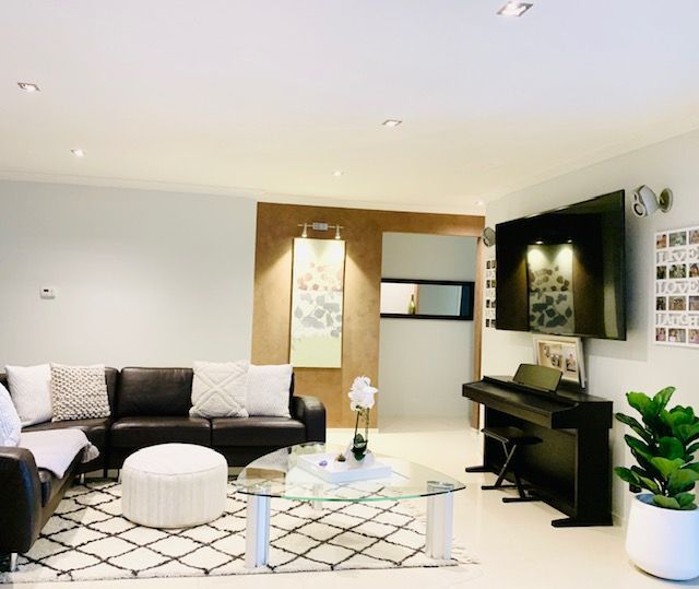

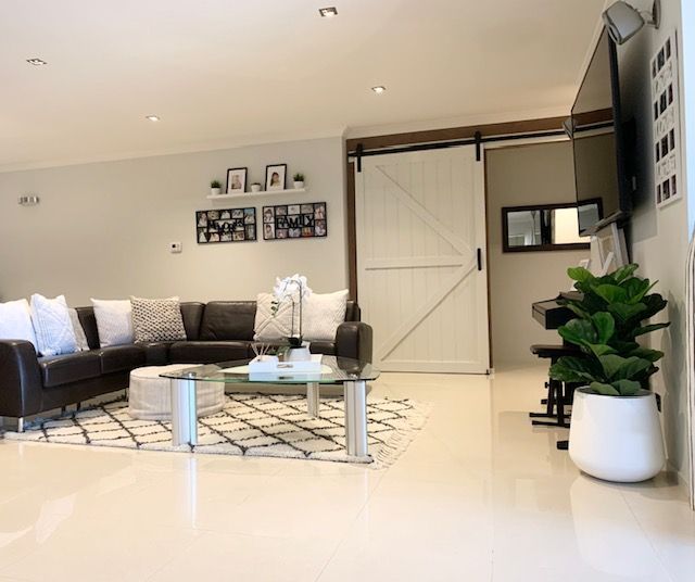

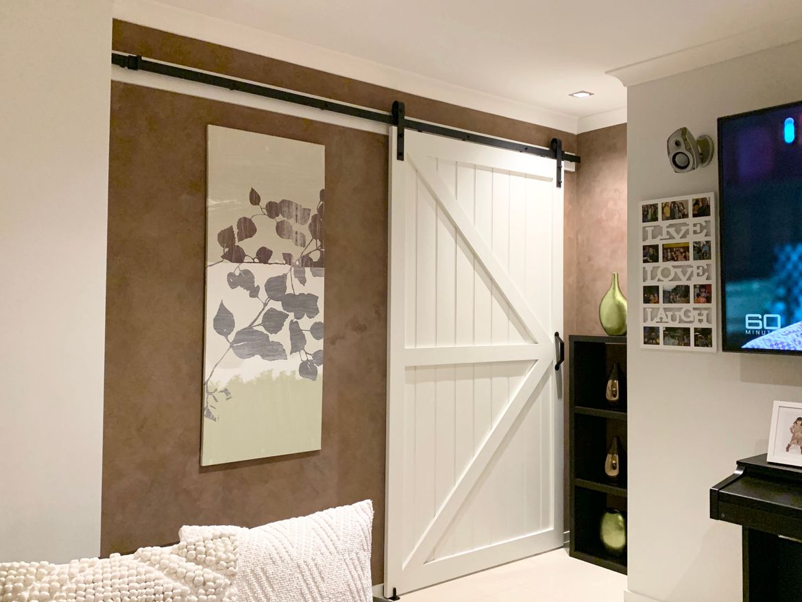

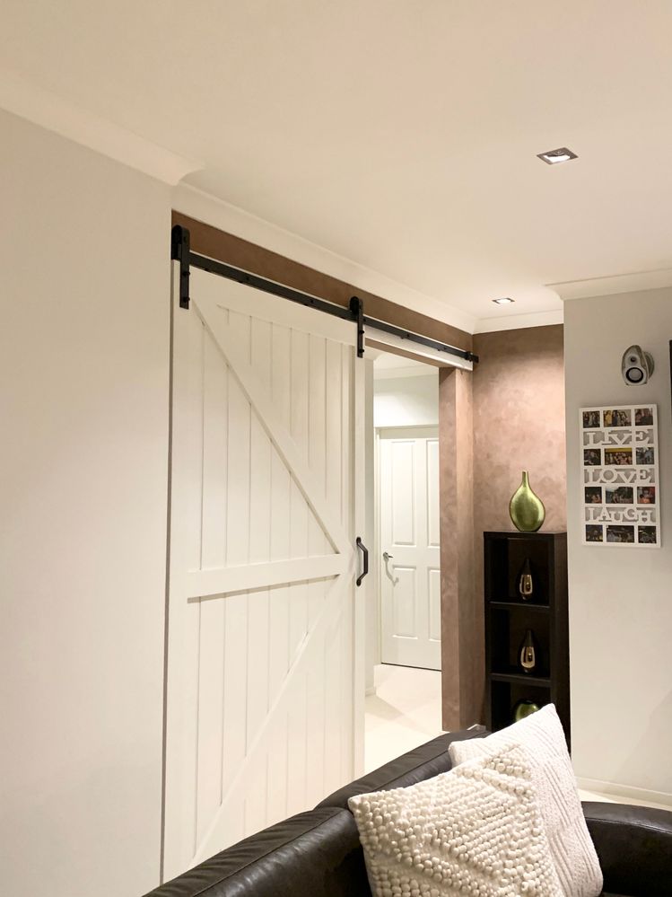

Step 8
8. Before & After - Completion
