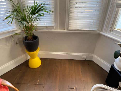

We are currently renting and have a bay window in our front living room. We would love to make a bench seat that would be removable if we move out.
Do you have any advice for building one- similar to a simply bench seat?

Thanks for your response. We’re looking at constructing more of a frame. Here is a photo of the area.

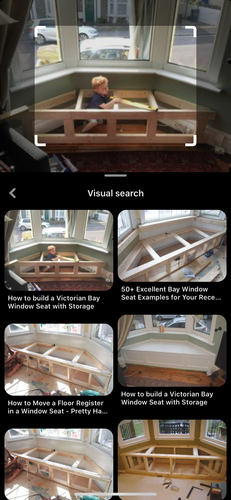

Hi @bernadette1990,
Your last image shows a fairly thorough visual representation of what you would need to build. The only difference will be instead of the rear rails fixing directly into the wall you will need a few more vertical timbers to support the top. You will have to create several mitred joints so a circular saw or table saw that can cut angles would be helpful. A suitable timber to use for the frame would be 70 x 35mm MGP10 UT Pine Timber Framing Linear Metre and it can then be covered with 12mm plywood for the top and front. A drill will be needed for fixings and Buildex 10-12 x 50mm Zinc Plated Countersunk Head Timber Screws 50 Pack would be a great choice.
