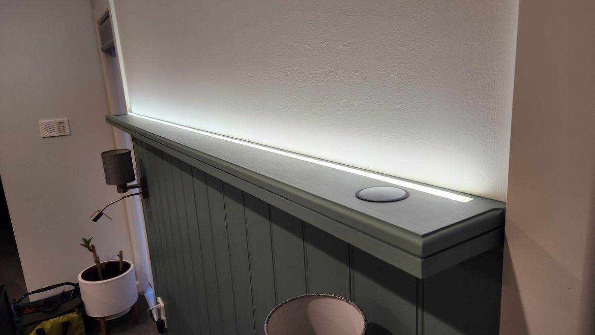

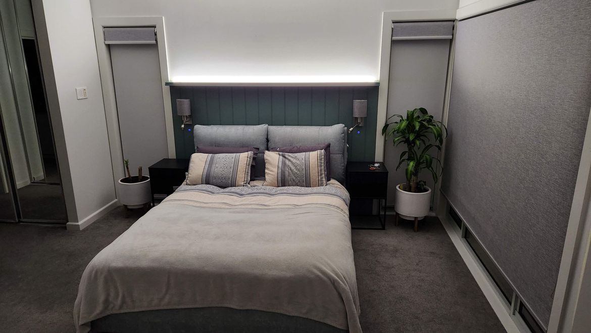

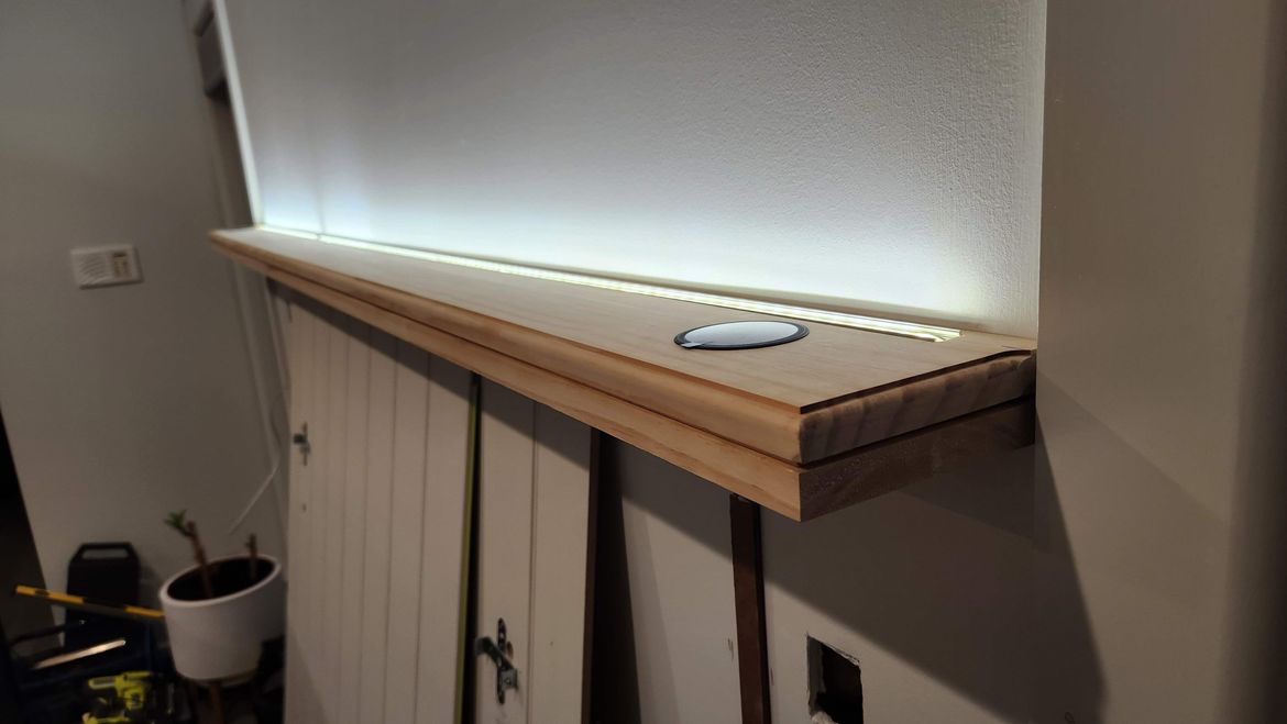

Feature wall in the bedroom build from VJ panels. It has a shelf with built in LED lights and wireless chargers.
We have used two VJ boards from Bunnings. They only have them 1200 W x 2400 H, but we needed them in in 1500mm high, so we used the Bunnings cutting service to cut them to 1500mm in store. This made it possible to deliver them in our car without using a trailer.
Materials from Bunnings:
Other materials (bought from other shops and online)
Locate the studs in the wall using a Stud Finder. Attach two packers along the studs to offset the VJ board from the wall by 6 mm. This should bring the feature wall forward and would look nicer along the architraves. By bringing it forward we could also get rid of the bottom skirting board and make the feature wall act as the skirting for the carpet

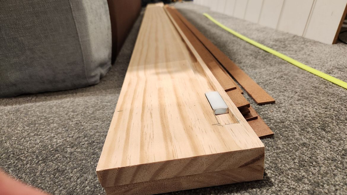

Cut the pine timber boards to the size.

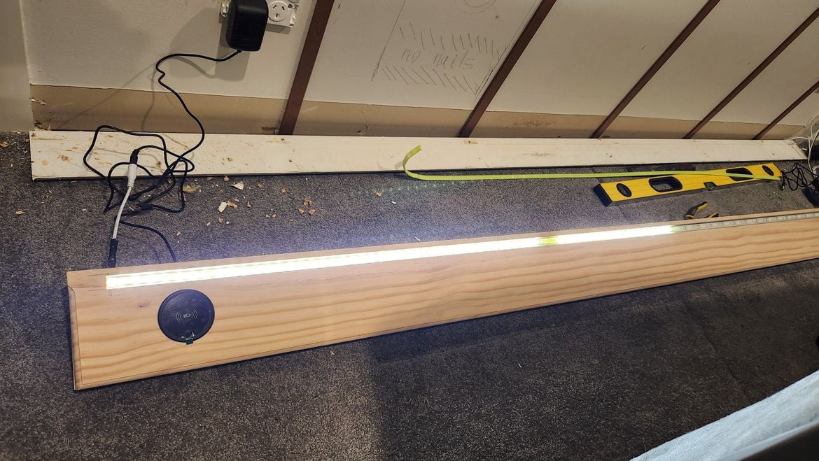

Using the router cut the groove in one of the boards closer to the edge for the aluminium channel.
Also using the router dress the edges using the timber bit of your liking
Cut 60mm holes in the board for the wireless chargers
Mark the position of the Attach angle to the top board of the shelf
Using the plywood offcuts space them between the two boards making sure that all the wiring and the angle brackets are between the two boards. Make small grooves for the wiring if required
Using the Multitool cut the holes for the powerpoints and the wall lamps. This way you would save money on the electrilcian. If he has to do it then you will most likely pay double for the job.
Attach the VJ boards to the wall.
Get a licensed electritian to connect the powerpoints and wall lights.
Paint the wall and the shelf. Enjoy

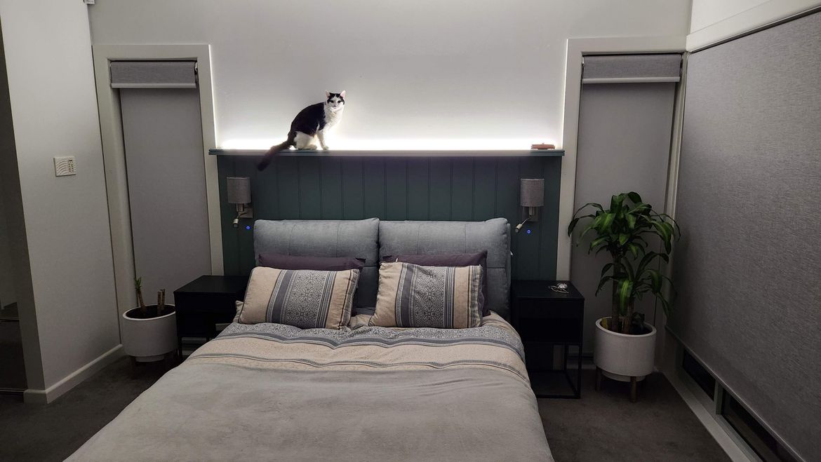

Nice work on the feature wall and custom shelf with inbuilt lighting.
The shelf looks fantastic, and your kitty shows just how strong and well-lit it is.
I just thought I'd mention for any viewers who'd like to replicate the look that you've actually used easyREGENCY panels, which are slightly different as they have the double line with beading running in between. Personally, I think they look more interesting than easyVJ, and they look fantastic in your feature wall.
