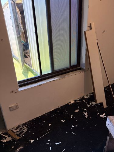

As per the images below I removed the timber board under the window as it sticks out and no furniture can fit, can you advise how to fill this hole now and make it flush with the wall… thoughts are to cut the board flash and refit but what else ?

Is this part of the aluminium frame, or is there a gap here?
Cutting the sill back so that it sits flush with the front of the lip is likely the simplest option, as it will conceal everything it did before; you would just have to touch up the corners with a suitable filler and seal around it. The alternative, based on the fact that your walls appear to be rendered, is to install a render bead on the front lip and then render and fill everything to match the walls. This is why I ask if there is a gap, because this would need to be concealed if you were to do this.

Your window sill, @JacobZ 's answer is where i would be going as well.

Window Frame:
I’ve got a gap of about 30mm under the window lip. To address this, I cut the timber back flush with the wall and reinstalled it. I was advised that I could apply Bondcrete to the timber surface and then render over it, as Bondcrete would help the plaster bond to the timber.
Can you please confirm if this approach will work? If not, what alternatives would you recommend? It’s a fairly large gap to fill, and I’d like to bring it back.red line approx. cutting in straight line
Gap under the window frame

Window Frame:
A1
I have not tried rendering over timber, so will have to leave a recomndation to one of the others ![]()
