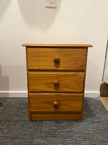

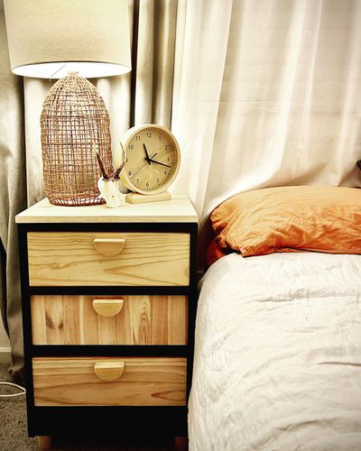

I purchased a dated set of pine bedside drawers and upcycled them. First I removed the draw facades and knobs and then removed the top and cut off the beveled edges. I sanded back to the raw pine and then painted 2 coats of British Paints water based prep 4 in 1 primer sealer undercoat-sanding between each coat . Then I finished with 3 coats of Porters Paints Eggshell Finish In Riverstone. I ended up using Feast and Watson liming white to ensure the pine wasn’t too yellow. Sanding inbetween. I purchased wooded tapered legs and half circle handles from Bunnings also. I cut the tapered legs in half. Removed the screw and replaced it with fluted dowels. I drilled holes in the bottom and used Sellys Aquadhere PVA wood glue to attach the legs.
