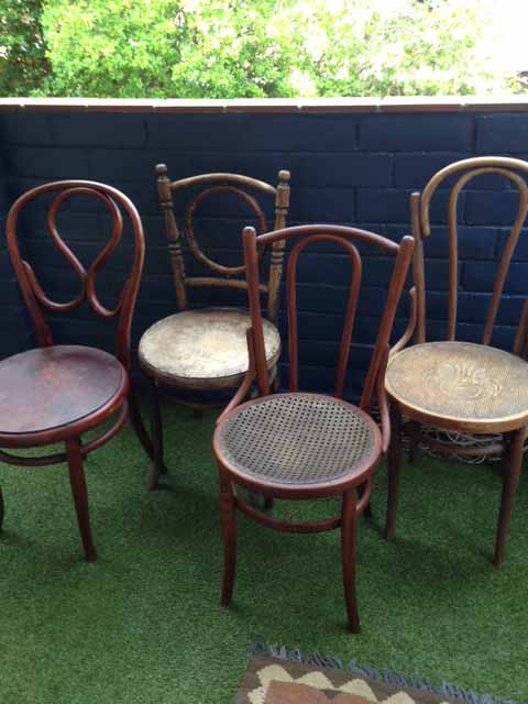

All 4 chairs are below, numbered 1-4, from left to right.
1. This chair just needs a tighten, a sand and refinish
2. The freebie. It was split and needed to be soaked, glued, and then finished. (images below)
3. Amazing chair with pressed metal seat!  Just needs a tighten, sand and finish.
4. This one is also split, so I will soak and glue it too before finishing.

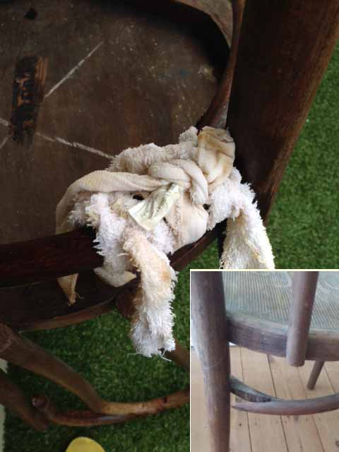

Chair 2:
The freebie owner told me to soak the split area and glue it.  I wasn't sure how to do this, but I came up with a good method.  I sprayed the area with water, and tied rags around it, then sprayed these with more water.  I tied the rags tight enough to give pressure, but not too tight to begin with. I just kept going with this.  Untying once dry and resoaking, adding pressure, until it came back to shape. The end result is a bit wonky, but aren't we all? Process pics below.
Chair 2 with closeup showing the splits
Chair 2 Soaking...
Chair 2 Success!  Soaked and bent back into shape (almost)

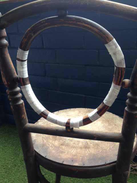

Chair 2 Glueing. I squeezed/poked Aquadhere into the split, and used masking tape as my clamp.
I still need to work on some splits/cracks in the seat as they would catch on clothing.  I'm not quite qure what to use here so would love suggestions?  I needs to disguise well and blend with the wood.
She needs a good sand as the glue got a bit messy, but I think it's going to be a success.

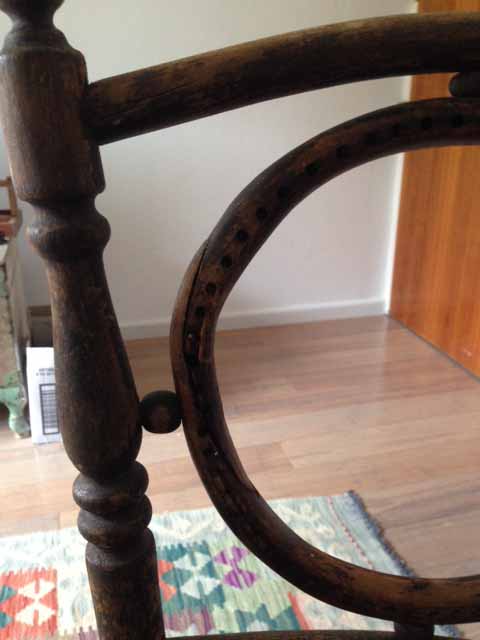

Chair 4:
Chair 4 showing closeup of split and the soaking process.  This is where I am up to.  When I get home tonight, it will have dried, so I will undo it, resoak and tie up with a bit more pressure.

PS. Chair 4 is proving to be a lot harder to bend. I think because of the part of the chair where the split is located, the wood is more solid and less flexible. My dad suggested I try a hairdryer to create steam, but then I'm not sure how to apply increasing pressure while doing this.
If anyone has any experience in this area, would love advice!
