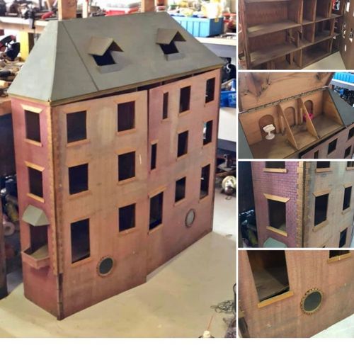

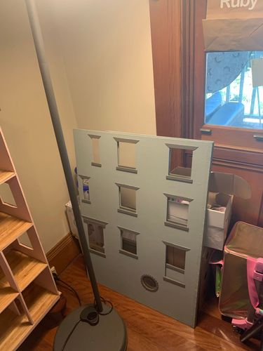

Hi all, I’m wanting glue advice. I took off these dollhouse doors off with the idea that I would take off the piano hinges and replace them as they were rusted. However the top layer of the hinge is actually glued on not nailed in. So instead I just treated the metal and repainted the hinges and door and went to reattach.... but the screws damaged the sides of the dollhouse. Now I need glue recommendations. To attach metal to MDF, it has to fast drying and doesn’t drip as I need to attach with the house laying down instead of being upright.

My recommendation would be Selleys 325g Liquid Nails Rapid Cure Strong Waterproof Adhesive. It has a 10 minute cure time on most surfaces and is clear, which means cleanup will be a breeze.
I'd also suggest either trying to move the locations of the screws or repairing the damaged timber. Even if you place some glue in damaged holes before inserting the screws should work. The glue will probably be strong enough to hold by itself, but having the screws holding on as well would be beneficial.
The only alternative I can think of to this would be some superglue, but I'm not sure whether that would be up to the task.

I totally agree with @MitchellMc's recommendation of adhesive. It's a rapid cure adhesive and should work well with bonding steel to timber. I suggest using a clamp if applicable to give you a very secure bond between the two surfaces. My only other advice is to place some cardboard under the hinge while it is drying off just to be safe.
