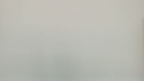

I want to hang my didgeridoo horizontally. I do not want shelving.
What are a few options I can look into to be able to have my didgeridoo sitting comfortably and stable?
Whatever I end up using will be going into drywall.
Picture of didgeridoo and wall for reference.

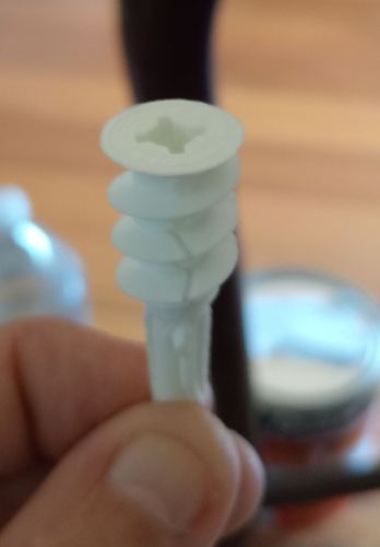

@JacobZ I ended up purchasing these wall anchors from Bunnings. I need to drill the pilot hole so I can insert the anchor.
I have every size drill bit but am unsure which size to go with so the anchor will fit snug into the hole.
My drill bit sizes are sequenced as 4. 4.2  4.5 and so on.
I don't want to use the wrong drill bit as I've not long finished renovating the room it's going in.
How do I tell which drill bit to use?

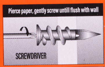

WallMates do not require a pilot hole. Simply push the tip into the plasterboard until it pierces the paper and rotate it in with a screwdriver.
Further details can be found here - WALLMATE Technical Data Sheet.
