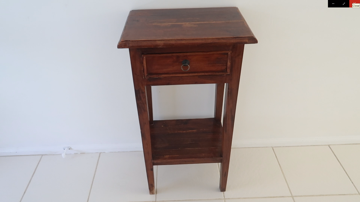

Every girl deserves a makeover at some point in their lives I think😁. I really enjoyed doing this little makeover and I've always wanted to try the household bleaching method to lighten timber once it's sanded back. I bleached the top and painted the base, added a few accessories and it's just so pretty. I think I might have to start selling these upcycles but I can't bring myself too once they're done, I love them too much😂. This little one is in the hall entry way and that's where she'll stay😂.
I've always wanted to try bleaching timber and it really does take out any orange or yellow stains.
She was still pretty before...
...but now she's pretty pretty and greets people when they come into the home!

Thank you @MitchellMc .The paint is called Rose Pink, it's a chalk paint from Kmart. I've never bleached timber before and when I first heard about it I thought it sounded weird😁 but it really works. I just used $2
household bleach and painted it on the sanded top with a paint brush. I let this dry in the sun, it didn't take long and then I repeated this step three times or until you greet the look you want. It not only lightens the timber but it gets rid of that orange colour. I then wiped it down with a wet rag, let that dry and then sanded it lightly again because the bleaching made it feel a bit rough. I then rubbed in two coats of beeswax which gave me the result you see in the photos. In the video I show you step by step the process😊

@EricL Thank you. I'm not sure what it was, it could have been from the stain, some spots were darker than others. The bleach tended to even out the colour and also lighten it😊
