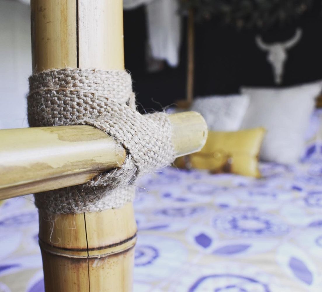

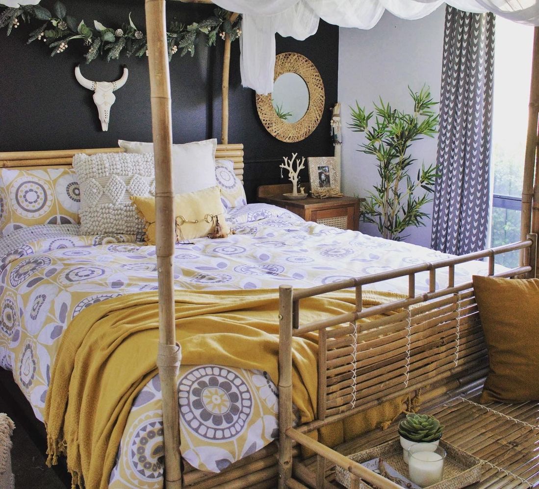

I bought bamboo posts and a bamboo outdoor screen to make a four poster bed.
Firstly, I started with the metal bed base and cable tied the upright bamboo posts, to it.
Then, I cable tied the ones running across.
When I was happy with how it looked, I screwed large screws into the metal base and attached the uprights.
Next I screwed the across posts, to the uprights.
I Cut the screening in half, length ways But used wire or a large cable tie, to hold the bottom bamboo On before it cut. Otherwise it falls apart.
Attached the head and end with large screws.

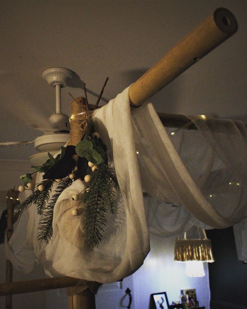

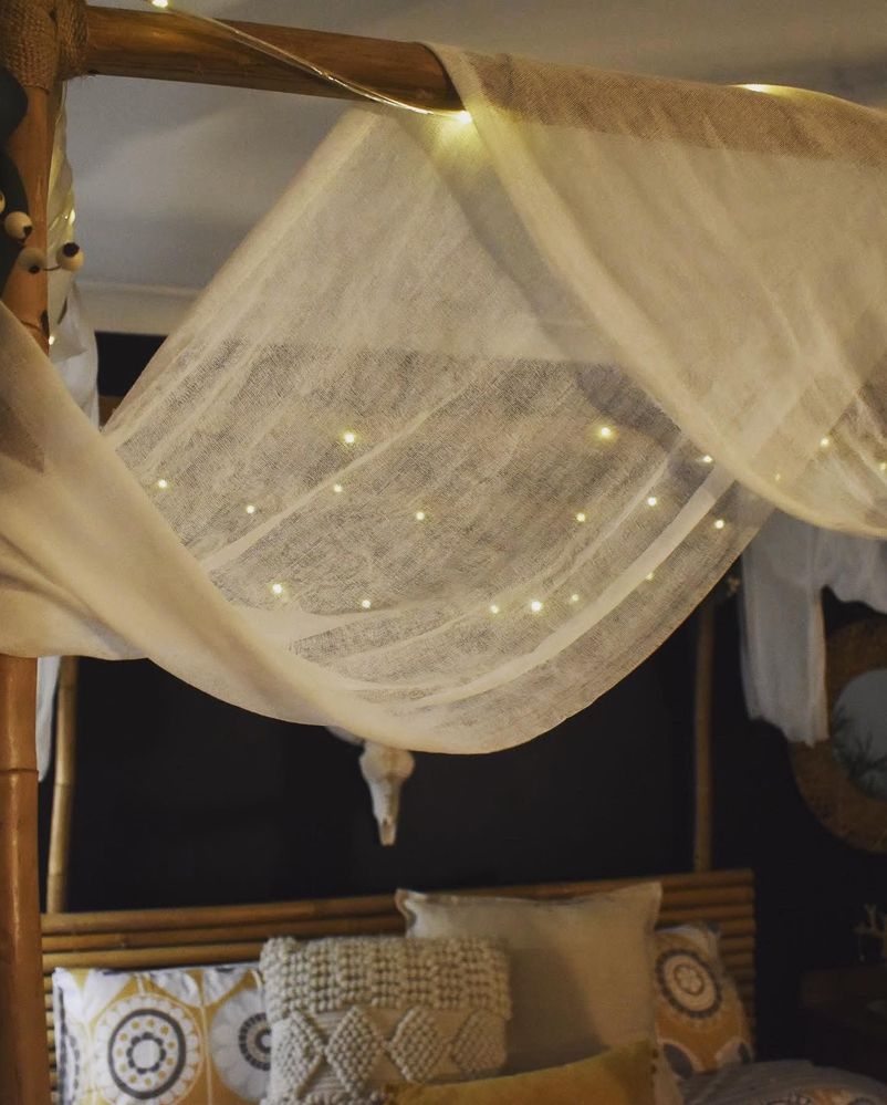

Lastly, decoratedAFAA6E38-12EB-4386-A02F-DD9734E4BC3B.jpeg0B51B65A-F62A-4296-B57A-A83C1F35FBEF.jpeg2450326C-8450-4F68-97DC-96463BE7BC88.jpeg9AEC7824-59E5-49A2-B2A4-3951A5A8DFAC.jpegF2CC28FC-F64F-4F1C-BD32-8106FA56B8D0.jpeg with Muslin and fairy lights ❤️

That's a fantastic retreat you have created there, and I trust you must be very proud of your efforts. I can imagine many teenagers would be ecstatic calling that their bedroom.
