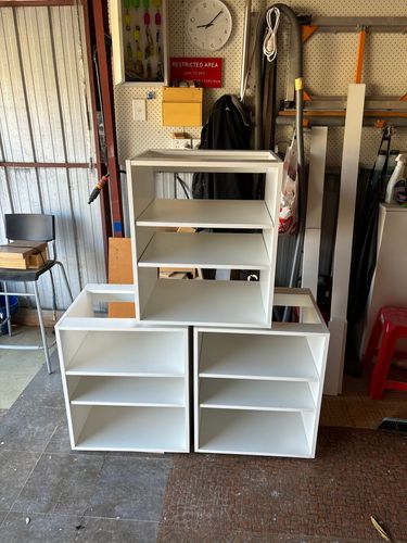

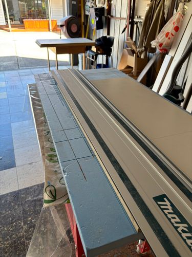

Steps
Step 1

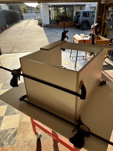

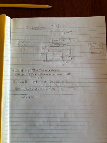

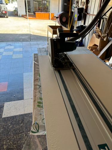

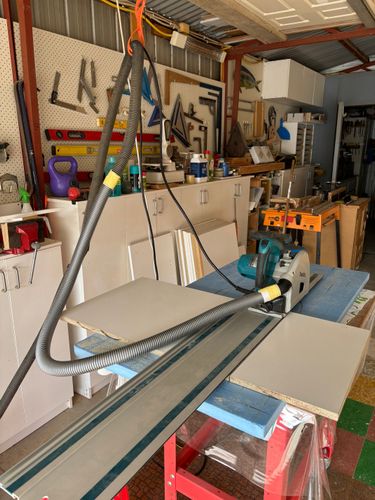

Measure and cut melamine sheets for shelving unit
i used a Makita track saw, I was surprised with the finished cut edge, no chipping of the melamine, this track saw allows a scoring cut of 2mm, then the full cut , reducing chipping.
JoeAzza_0-1729063715938.jpegJoeAzza_1-1729063746388.jpegJoeAzza_2-1729063791453.jpegJoeAzza_3-1729063829830.jpeg

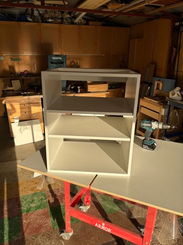

Step 2

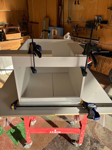

Install edging, drill shelving pin holes, using home made pin shelf jig
Measure cut adjustable shelves, install edging.

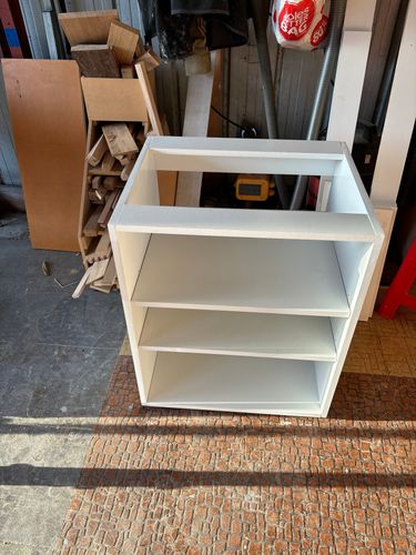

Fit adjustable shelves

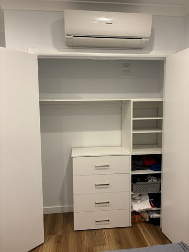

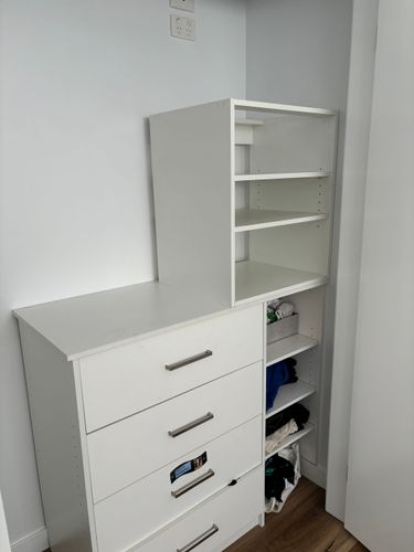

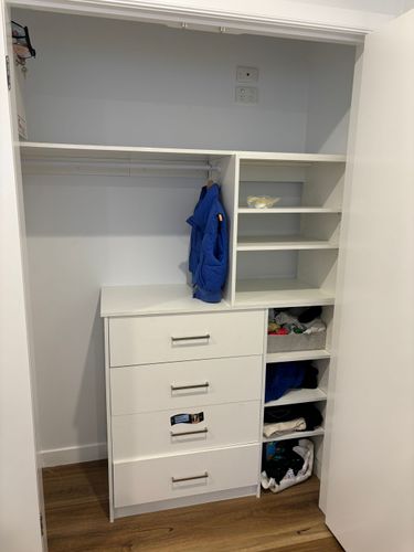

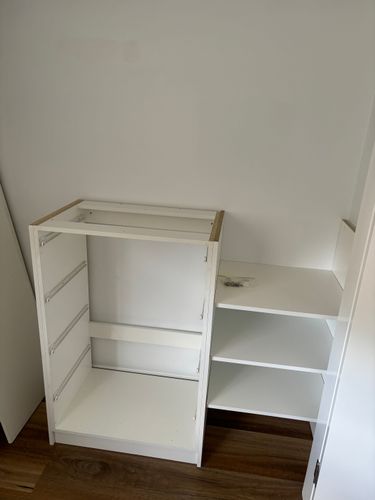

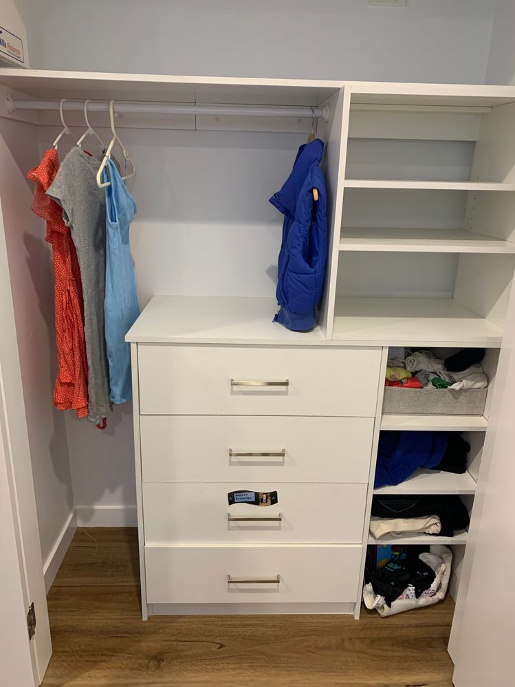

Step 3
install existing shelves and drawers.
install new shelving
install top shelf and wardrobe rail
JoeAzza_10-1729064439450.jpegJoeAzza_12-1729064521401.jpegJoeAzza_13-1729064564156.jpegJoeAzza_14-1729064595477.jpegJoeAzza_15-1729064663402.jpeg
