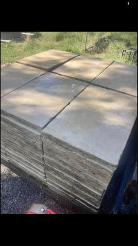

Hi Bunnings brains!
Having a freestanding wood stove installed and we would ideally like a thick stone hearth on our floorboards, without a layer of compressed fibro/cement in between. Is this possible and compliant or problematic? How would you recommend preparing the floorboards to ensure a flat installation of the stones?
Thinking of using 40mm thick paving stones in large pieces 400 x 600mm. So possibly 6 stones all up.
Also, can anyone recommend a product to join the stones together in between?
If a fibro / cement layer is essential, can you get thin sheeting that doesn’t ruin the aesthetic of the natural stone in profile?
example of stones in pic.
Thanks 😊

Before you begin your project, I recommend having a look at your local council rules and regulations relating to the installation of a free-standing wood stove. Because it is an open fire, it would likely fall under the same regulations as a fireplace. Some councils require that the back wall be lined with fire-resistant material. Others require a stone hearth with an appropriate lining underneath.
Your plan of putting in a stone hearth could line up with the council rules. As for the mortar to keep the stones together, I suggest using Lanko 5kg 156 High-Temperature Mortar. It's formulated for brick and pizza ovens and should work with your hearthstones. If the council requirements dictate that a cement sheet be placed under the stones, you'll have to follow the rules. To keep the look of the hearth without seeing the cement sheet you can always use cut pieces of the stone as a liner on the side of the hearth to cover the exposed side.
