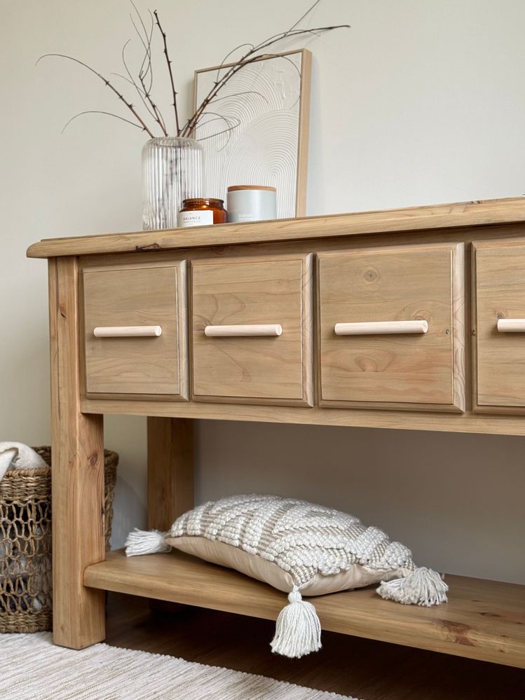

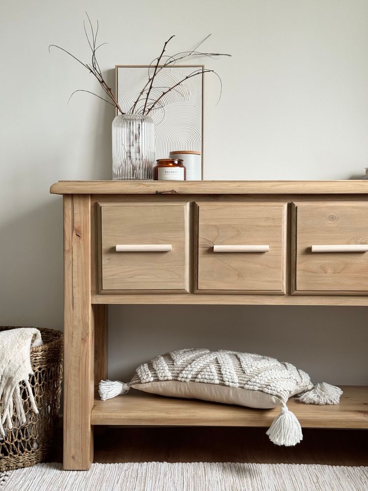

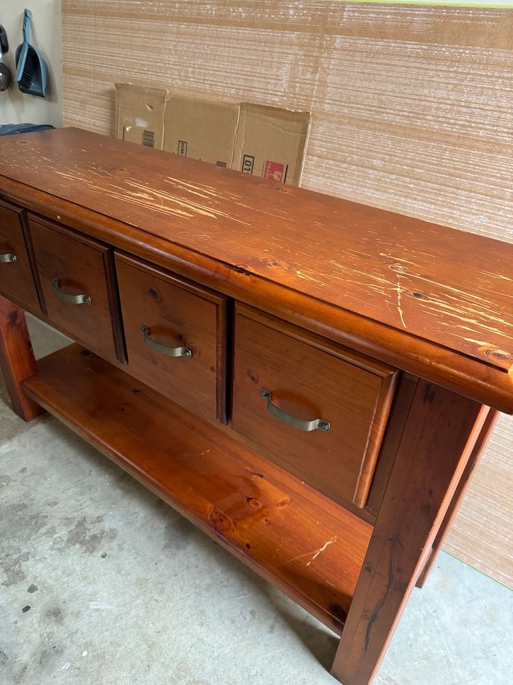

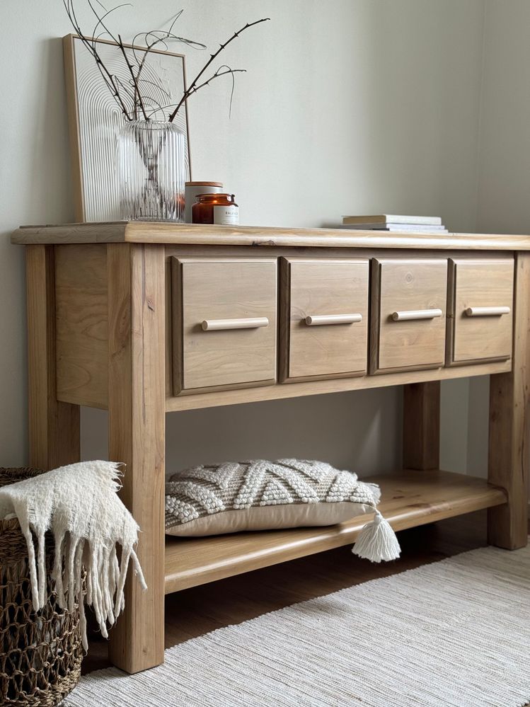

I wanted to update this old console to create a fresh coastal feel. I'm really happy with how it turned out! A full video of the process is also available on my Instagram - taylermayd_
BeforeBeforeAfterAfter

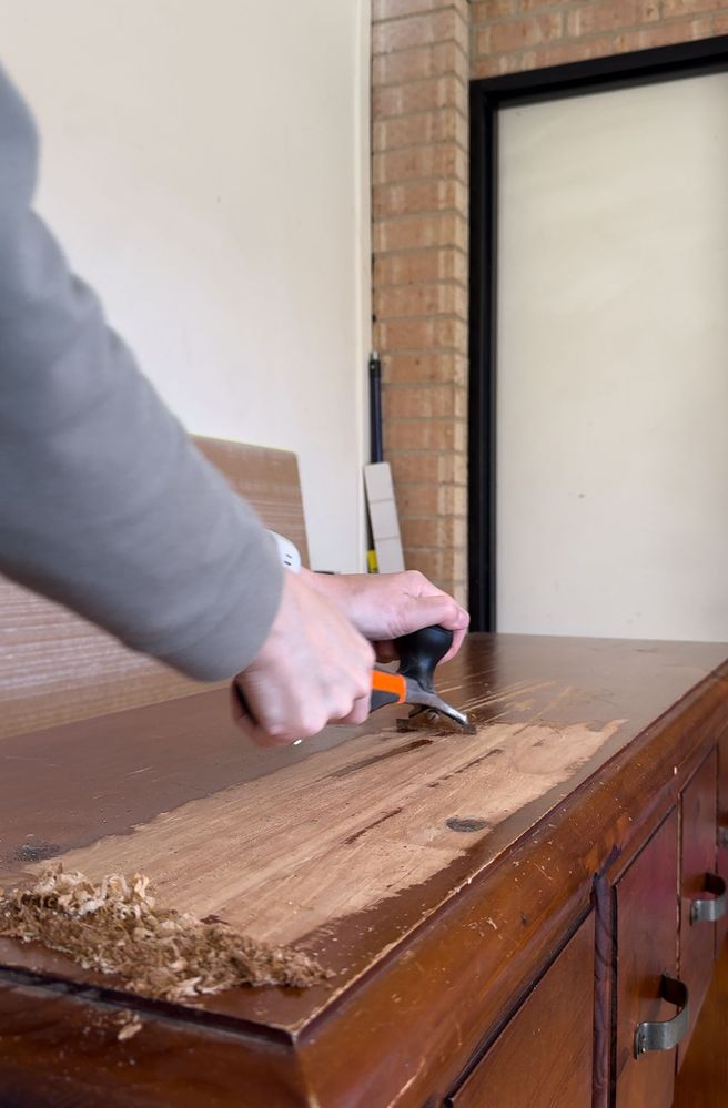

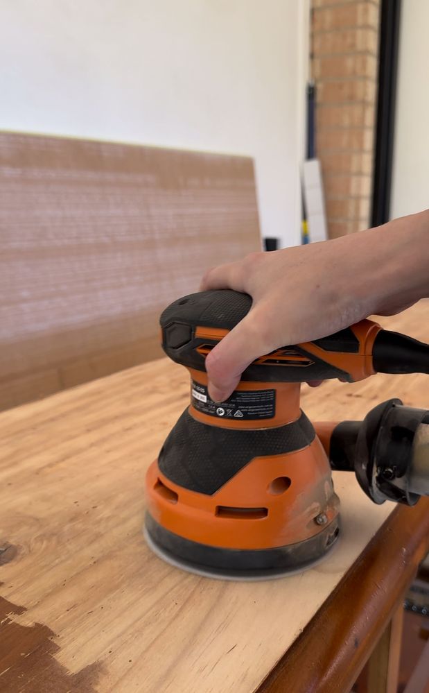

I started by removing the handles and all of the existing finish. I used a carbide scraper to remove the varnish, followed by an orbital sander to reveal the natural timber. I worked up from 120 to 400 grit sand paper to ensure a smooth finish.
I used my Ryobi multi tool as a detail sander for the hard to reach areas.image1.jpegimage2.jpeg

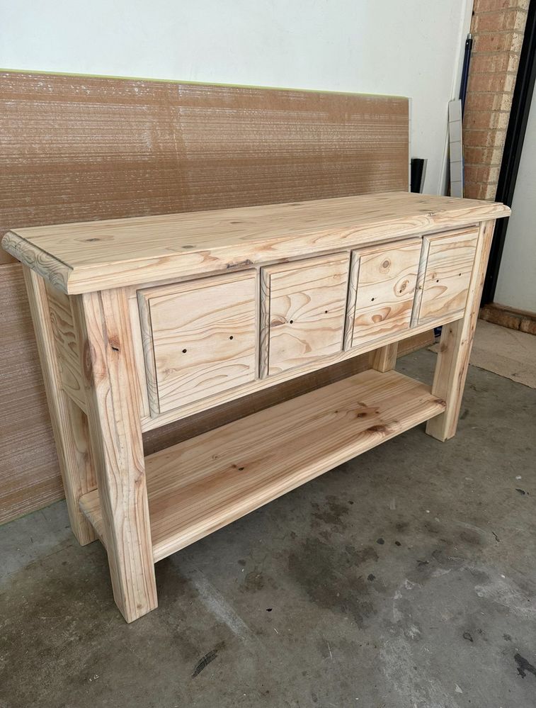

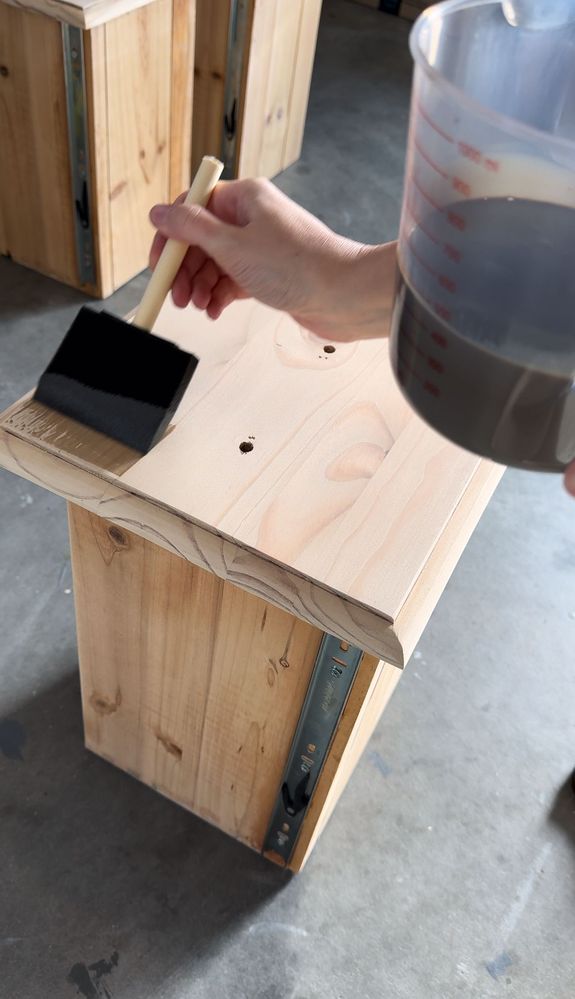

Once the old finish was completely removed, I gave the sideboard a thorough clean and applied a light paint wash;
I then used a foam brush to apply one light coat of Cabot's stain and varnish, followed by two coats of just the clear; I sanded with a high grit sandpaper between coats to ensure a silky-smooth finish.
Step 3
For the handles I cut some pine dowel to size using a mitre box, sealed the dowel with clear coat for durability and fastened to the drawer fronts with wood screws. And this is the final result!

Beautiful results, @TaylerMayd. I love the finish you've achieved, and it certainly matches your coastal brief.
You've done a wonderful job removing the previous coating; I know how much work that can be.
Many thanks for sharing, and great work.
