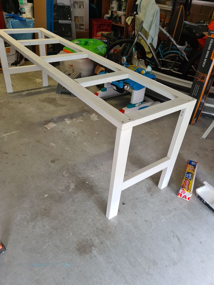

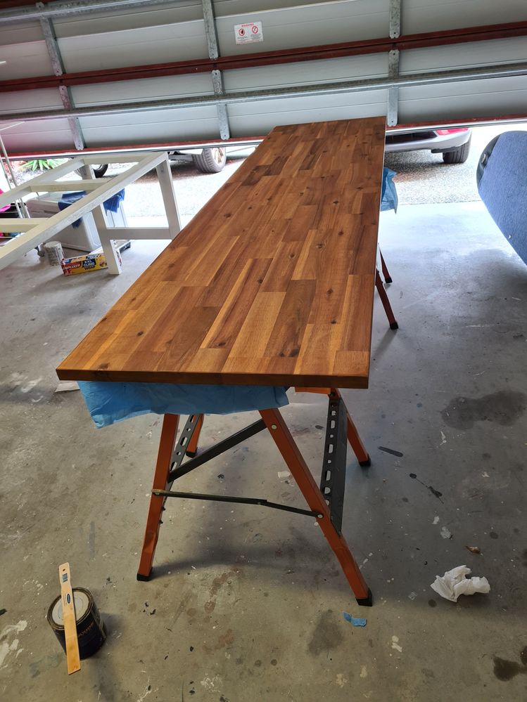

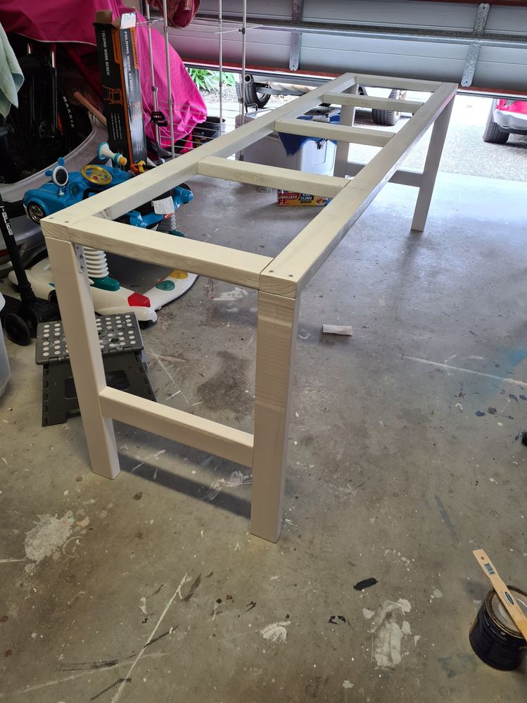

20210106_115353.jpegI thought I share my build for an affordable computer desk as most of us are now working from home. I needed an extended desk to fit into the study but couldn't find anything within my budget. My budget was under $150 for a 2-metre long desk. It's a straightforward build, and anyone can do it. It was my first desk that I have made.
Measurements
  • Length 2000mm
  • Depth 500mm
  • Height 790mm
Materials from Bunnings
  • untreated Pine 30 X 70 mm for the frame
  • Brackets for the legs
  • Wood screws
  • Worktop was 2200 x 600 x 26mm
  • Stain Linseed Oil (ikea)
  • Leftover white paint from Dulux (white on white)
Update: It has been six months, and the table is holding up well. I built another computer desk with my son for his room of similar size, and he loves it.

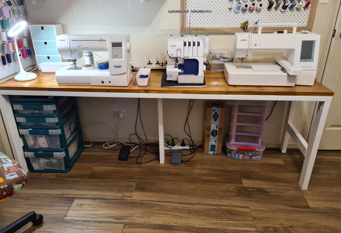

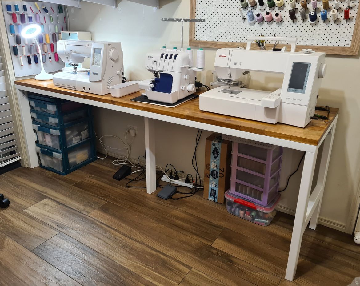

Well I've finally built my sewing table.(and cleaned out my sewing room to do it justice)
It took a while but I'm very pleased with the result.
I now have a "sewing center"
Thanks heaps for sharing your design and your suggestions
Regards
@rubytuesday1953
