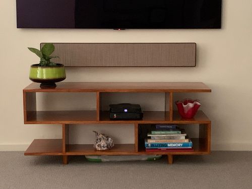

I have finally completed my project. While I am pleased with the result (see pic. - very stylish I think haha) I must say I did have issues with the bowing of a couple of the finger jointed panels I used (mitigated with some strategically positioned screws), and also they weren't exactly the same size.
I decided to stain and varnish and accidentally picked up an oil based product which I found very difficult to apply evenly - I'm not really pleased with the finish but it's bearable.
Thanks again for all your advice Mitchell.

Thank you so much for posting an update on your shelving unit. It looks wonderful and I don't see a hint of bowing. The design you've chosen really makes it look very modern. I was thinking of a traditional box type construction, but the offset dividers and open sides just give it a very custom look.
