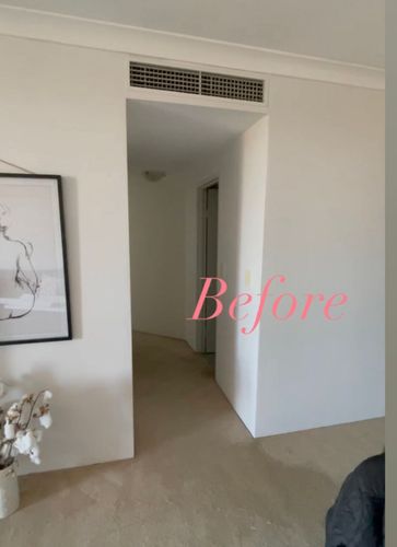

1. Our apartment is brick/concrete so drilling was tougher (and super loud!)
2. Our hallway entry where we were planning to instal the barn door was HUGE.. I couldn't find a door that would fit the space.
3. The top of our hallway was an aircon vent (I didn't realise this until after I purchased everything .. I know.. silly.. bf wasn't impressed haha) so installing the Rolltrak for our barn door was going to be difficult.
So this meant we needed to build our own barn door AND just adjust how we installed the Rolltrak railing.

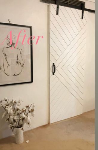

For the Barn door, we purchased 12mm ply wood as the base and I bought planks of white Primed Pine DAR to create a pattern for the front of my barn door. All together for the materials and accessories it cost us.. wait for it... under $350!
Now when I said I winged it, I wasn't joking. At this stage I started to panic about the weight of this bloody door I was building which was already a work in progress. Word of advice, check the weight of everything if you can!! I had the fun job of weighing my door on scales.
Once we realised everything was still within range (phew) we continued to build the door. This part was relatively fun! The only hard part was cutting the door to size.
Once that was all done, we painted the door with left over paint we had lying around, installed the handles and the Rolltrak pieces on the door, and Bob's your uncle!
Here is a photo
Im super proud of what we did. Its a beautiful edition to our apartment and ads character.
Anyone looking to build a barn door from scratch, DO IT!
