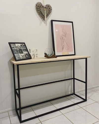

I simply didn’t want to pay $200 to get the look so made it myself.

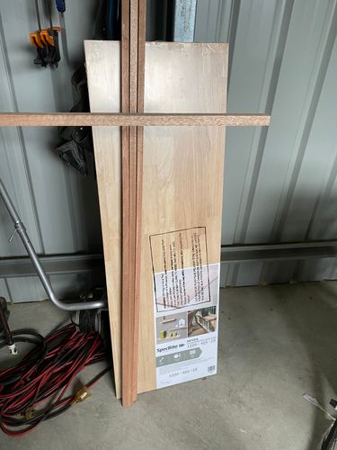

Using a timber project panel and hardwood DAR, this project was fairly simple to put together.
I even saved money by using a Porters Paint sample put for the frame.
Total cost $68.55 for
5 x piece of Meranti 18 x 18 x 2700
1 Heavea project panel 450 x 1200
1 Selleys PVA glue
1 Porters Paint sample pot - Aniseed
Re: Hallway / Entry Table
Welcome to the Bunnings Workshop community @craftyhopper. It's wonderful that you've joined us, and many thanks for sharing your project.
That looks absolutely sensational! You've certainly nailed the look as it appears to be a store-bought unit. Did you sand the Hevea panel down, as I love the natural finish?
Do you have any other images of the construction process, or could you share details on how you joined the Meranti together so professionally? I trust any of our members attempting to replicate your amazing project would appreciate further information.

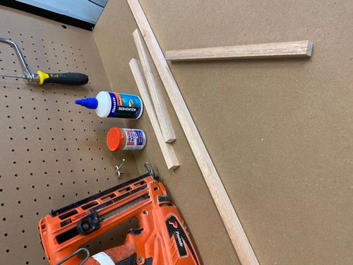

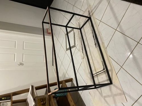

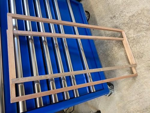

Thanks Mitchell
I’ll upload some progress photos 😊 As for putting it together, it was simply PVA glue and a nail gun. I left the Hevea panel as is and didn’t sand. I will see how it fairs and if it needs it, I’ll add a clear matte varnish.
