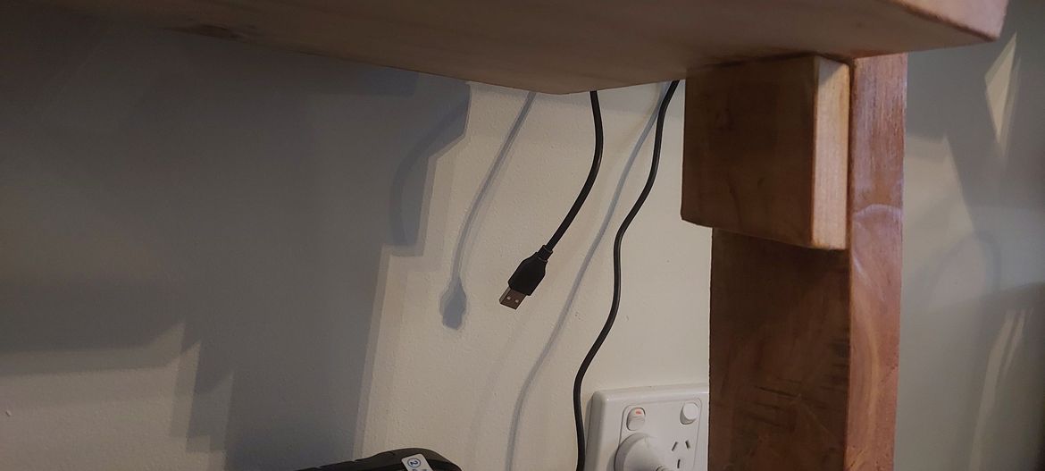

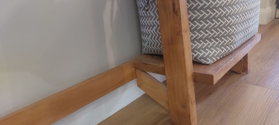

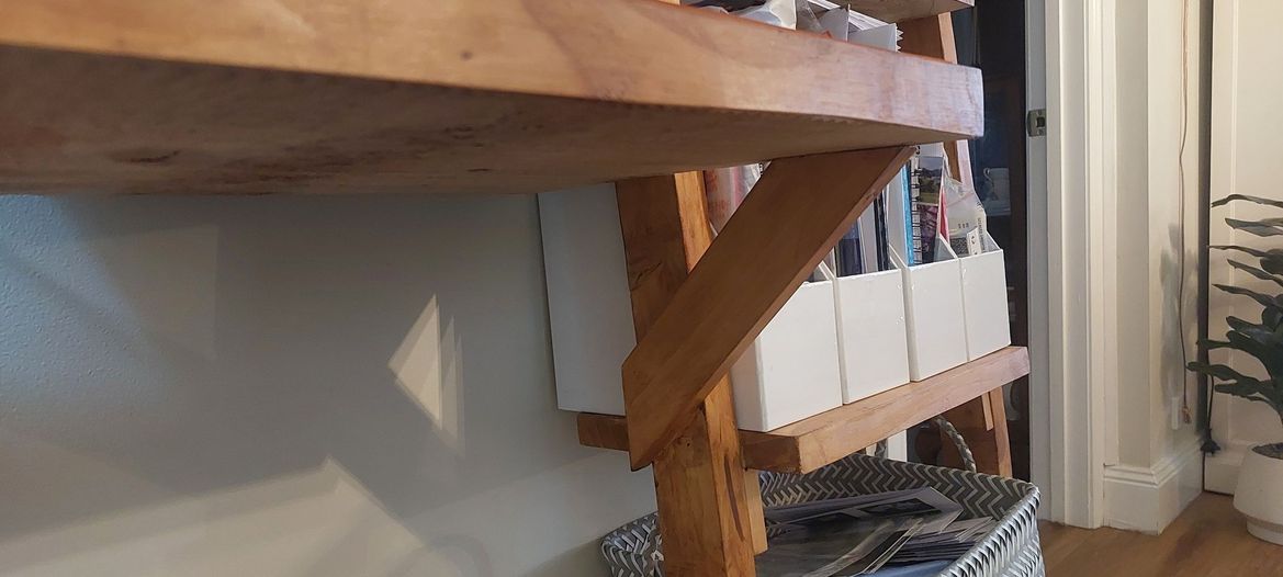

The work desk and lower two shelves, left and right sections need structural support as shown in the photos.
