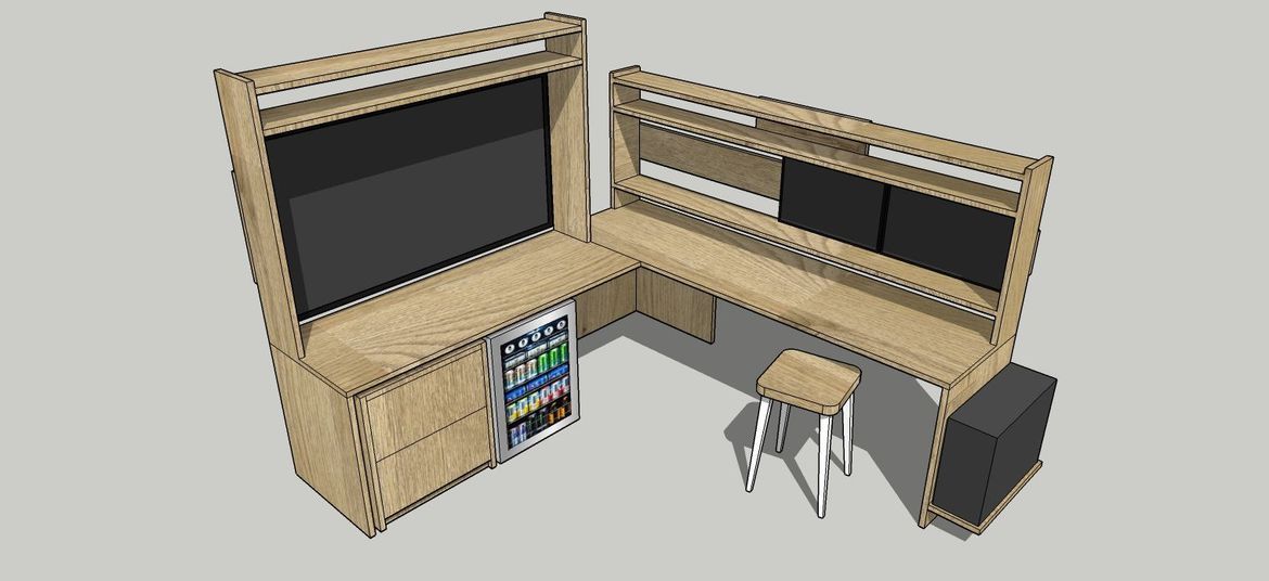

Hello @Kafunta
Beech laminated panel! 1,001 uses. Below is a drawing of what you can possibly do using beech laminated panels. Taking over the world requires a good desk. The beech laminated panel from Bunnings is timber through and through not a laminate cover over fiber board. I can understand your worry and hesitation when using this timber. As explained by @MitchellMc when you cut the laminate timber, it is timber all the way. If done properly you can set up your command station with everything you could possibly need. As you can see, you have your computer with two screens. A big TV to keep up with current events (footy) and because all that hard work requires refreshment a glass door mini fridge to rejuvenate you with your preferred liquid when its critical (half time). I would have placed a microwave but I'm sure you would still want to see your family. Enjoy the drawing and don't let limits hold your imagination back!
Cheers!
Red
That filing cabinet? Beech laminated panel! Also can be snack cabinet!
