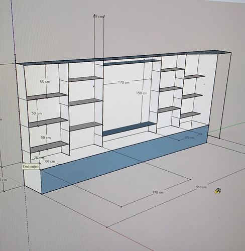

james73
Budding Contributor
Re: Design for storage around TV
Thanks Red I have found thanks to this site sketchit and here is  my first draft love using it and would love your feedback still trying to keep cost down with mdf but wondering what thickness should use don’t want saggy shelves
redracer01
Trusted Contributor
Hello @james73
Congratulations you've just stepped in to a larger world of planning and diy!
- try using the push and pull tool to create thickness for your panels. A good default thickness is 16mm.
- consider where you will assemble the cabinet. In the garage and transfer to living room or straight in to the wall and assemble in the living room.
- dust, debree and mess must be taken in to account when assembling in living room.
- time allocated for the project.
- wires and cable consideration, where will they pass through and will you be drilling in to the shelves?
- shelf led lights Yes? No?
Just some things to consider. I will get back to you on the mdf issue.
