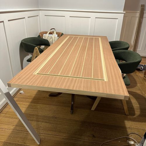

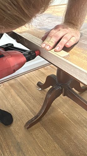

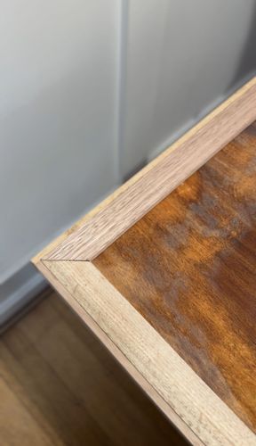

Add external trim & frame
Adding a frame is important to cap off the edges of the wood. Adding it before assembling the table top ensures flush finish. As you can see we have used a template piece to ensure the correct height (8mm).
Use a nail gun or small nails to secure the trim to the surround of the table.
I wanted the picture frame look but you could just do the outer trim. If you like the picture frame, add the 45 deg mitred pieces the length & width of the table. Secure with wood glue.

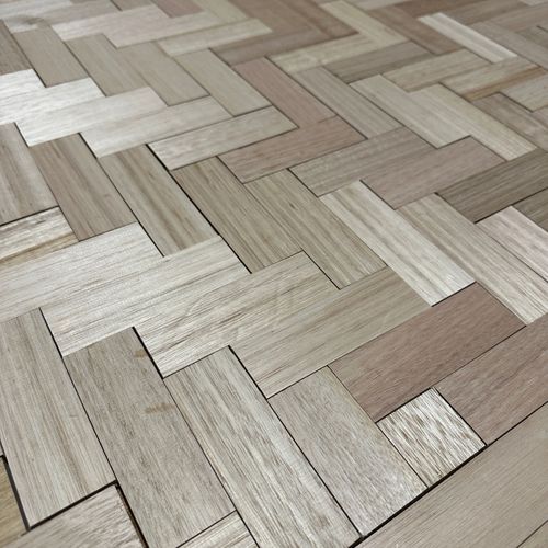

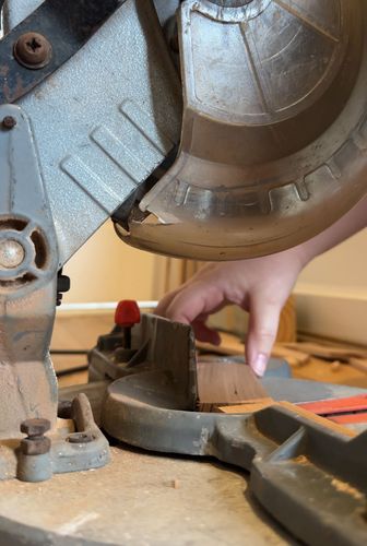

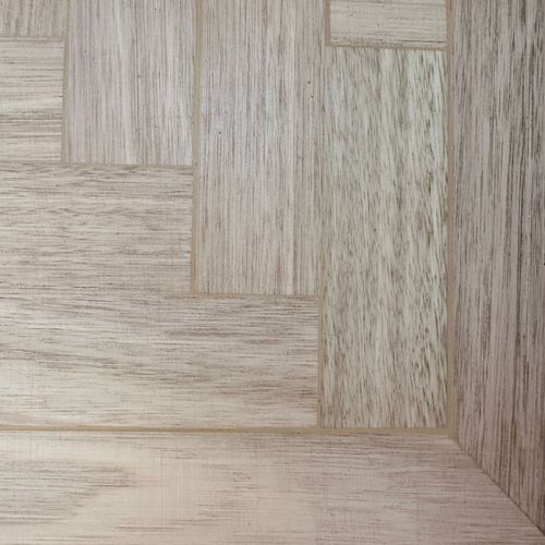

Measure and cut pieces.. 
I decided on 120mm pieces because I liked the tight look and pattern.
TIP: with Herringbone the rule is multiples of the width (used 40mm pieces so measurements should be 80mm, 120mm, 160mm etc)
TIP: to work out how many pieces you need - work out the square cms of the table top (length x width, then divide amount by the square cm of each piece)
Yes, it’s a lot of pieces!
Step 3

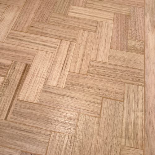

There are templates online if you’re unsure. Filler prices of 80mm x 40mm and 40mm x 40mm were needed for this pattern.

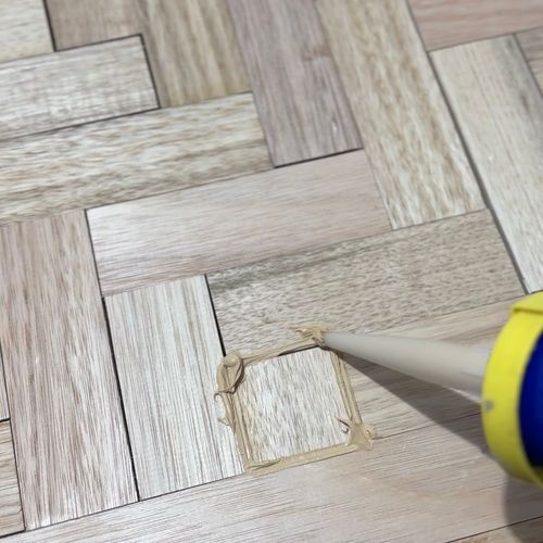

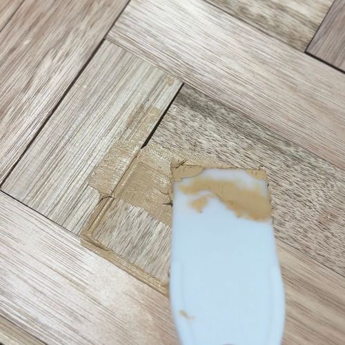

Fill gaps with ‘No more gaps’
Scrape clean and wipe with wet cloth.

Refill no more gaps if needed and light sand
If there are any pin holes or gaps you missed it’s time to fill them, then sand with the orbital sander. Used 120 Grit then finished with 240 Grit.

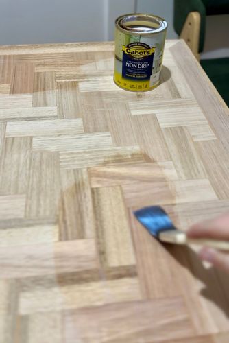

Coat with Cabots
TIP: light sand (240 Grit) between coats.
