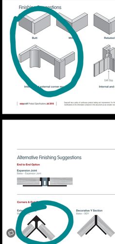

Have watched some videos, however specifically looking at how to handle the corners/joins. Don't have access to a table saw to cut angles into the boards - would this be required? Thinking yes..

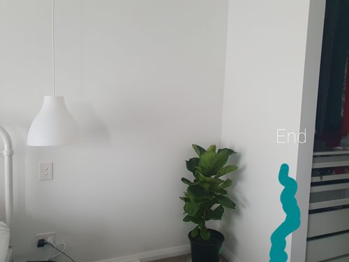

Second how the boards could look when you can see the 'end' - and options to finish it off. (see pic with 'end squiggle')

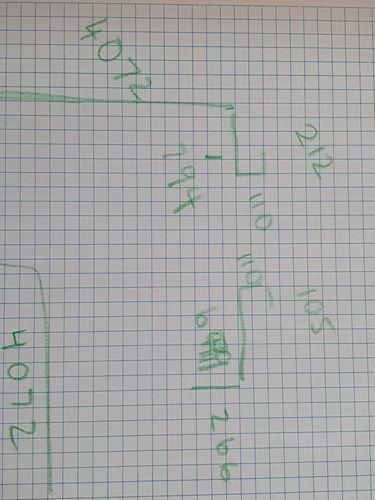

Have attached a rudimentary plan:
Option 1: just do the bed head wall of 4072mm
Option 2: bed wall and join in the corner to side wall (794), even it up with other side wall (699).
Option 3: wrap around the cladding into the BIR (but have ruled this out - the boards are too thick for smaller spaces.

Crayon plan:

There are a few different mouldings that could assist in covering your cuts on the internal and external corners. The Porta 12 x 12mm 2.4m Tasmanian Oak Quad Moulding and Porta 20 x 20mm 2.4m Tasmanian Oak Round Edge External Corner Moulding would be suitable if your cuts are not perfectly straight. If you're planning on having exposed ends of the panels, then you could use some Timbermate woodfiller to fill any gaps between panels. You might like to check out the Easycraft installation instructions as it lists some complementary products.

I suggest using 1.5mm aluminium angle trim instead of timber simply because it's so much thinner and more seamless. You can see this in a recent project I completed. Just prime with with an aluminium Etch primer before painting to match your panels.

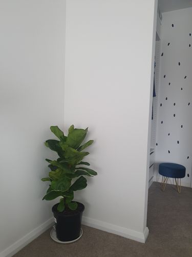

Re the 'width' of the boards - bad explanation on my part. The boards are 100mm wide, and on the 110/212/105mm wide walls that wrap around into the WIR, it may look a little odd/dificult to be symmetrical. (for my skillset).

You'll need to pre-plan that corner into the WIR to get the boards matching correctly. You are correct that depending on where the V-grooves fall; it could look a bit odd. How thick is the wall there? Remember, you'll have the 100mm width of the board and then the two corner angles that are 20mm wide, so depending on where the V-grooves fall, you could offset the board's position. Pete might have some handy tips. I think it might be best to start your boards at the end of the partition wall and work around the room from there.
@Louisecomau The panels are actually 1200mm wide. Each groove is spaced 100mm apart.
Depending on the overall style you're going for, easycraft offer a MTO (Made To Order) option of 63mm grooves (which i used on the recessed TV wall) which offers a more modern finish and may be better for the 100/212/105mm walls as you're guaranteed at least 1 groove on that section if that's what you're trying to achieve.
The ali trim @MitchellMc mentioned is the one I'm referring to although I used the 10mm profile rather than 20mm.
